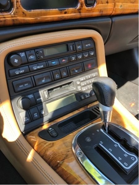

I would remove the arm rest box and surround trim. This is where the big yellow radio plug is, and where you would typically install any type of satellite/Bluetooth adapter. The fact that the trim between the seats does not match with the rest of the dash is a hint that someone has been there before, possibly. Separately, there are a number of "hacks" to be done to the radio to be able to bring external sound in, like cassette adapters, etc. Maybe if the radio "thinks" there is a cassette stuck in, it does not turn off.
Best of luck, keep us posted.
