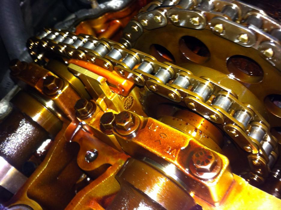

Please look at this tensioner
I opened up driver's side cover (left) and here is my tensioner, attached. I think date on it says: 8/06, so I suppose it was updated. Also, it looks like the engine front cover also came off at some point, because the hood has sharpie markings around the hinges and also I saw some extra silicone, down the main chain area.

What do you think of the tensioner, it looked like its body was aluminum?

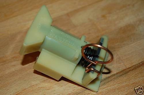

That appears to be a "plastic" tensioner in the picture. If so REPLACE IT!!!!!
No matter what the date stamp says. If it has an alloy metal body you are good to go. Hope you determined that before you buttoned it up. If not...you are not done!! The guide on top of the tensioner looks red, the new metal bodied ones have a white slider on top.
My sliders were severely galled and had cracks in the plastic tensioner body. I also replaced the main chain guides as they had cracks, along with Primary tensioners and new chains. You really should do it all in my opinion. Car had 65k miles.
Everyone trying to "get by" with just the secondary tensioner replacement is playing roulette IMO!!!!
Mish_Mish check it again, be sure it has metal body (4.2L type). There was an "improved" plastic one but the final fix was a metal one.
Steve, 100% agree about changing the tensioners...but I think he already has the metal ones. Even the plastic ones (see photo) started out white...heat, age and engine oil turn them red.
Yes, these are metal body, it is oil deposit that made them reddish, slider head was origanially yellowish, under the sludge.
I will be checking another side and replacing gasket + plugs, so will see another side soon.
Also, it looks like main chain tensioner body was also metal, looking from the side. Also, I noticed some sloppy silicone sticking from under the front engine cover, towards the main chain, so maybe nice Cuban mechanic got that done for me, back in florida
