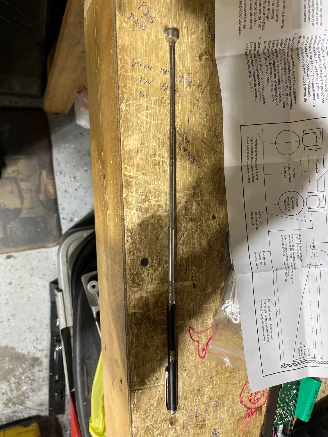

Hey don’t panic, I got a simple solution that worked for me recently. Last month I did the drill a 2” hole method(I did 2.5”) but i faced the same dilemma when trying to refit the plug. To remove it I bout a set of “wobble” extensions from harbor freight that worked great. But found upon trying to refit plug that Erie sense of “am I cross threading it?” So here’s what I did;
1. Took the plug over to the bench grinder with a wire wheel and cleaned up the corrosion on the threads real nice.
2. I took a retractable magnet(like for fishing out dropped bolts and such, I’ll post a pic if I can) and extended the first few parts.
3. Taped the sections with electrical tape to keep them from spinning.
4. Stick the magnet on the plug inside the square drive hole and carefully start the plug in the hole.
5. After a few turns, When the plug reached the resistance and the magnet started to spin on the plug, switch back to the wobble socket and carefully tighten it up.
this allowed me to go by feel to get the plug started, but if I had it wrong the magnet would spin and I would start over. Give it a try
