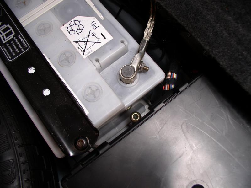

If your battery is a Jaguar OE Varta, you can check the manufactured date. It's stamped on the top of the negative terminal.
You can just make it out in this pic. The code is WW/YY for Week number and Year. Anything over five years old is on borrowed time.
