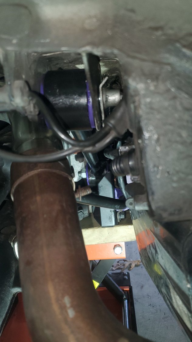

Those who have followed my rear subframe refurbishment in that thread have seen that I ran into issues with the differential strut bushings from Powerflex, part PFR27-209. The flanges on these bushings are too thick to fit in the seat on the chassis, which Powerflex have agreed is the case based on dimensions and photos I sent them. Although their response time in the dialogue hasn't always been ideal, they owned up to the error and have offered to make an adjustment to a set they have in stock in the UK and expedite the shipping to me, presumably without charge. I understand they will make new molds for future batches.
It's worth mentioning that I had no trouble with any of the other bushings from them (I had ordered the full rear subframe range).
Posting this in case others are contemplating a rear poly upgrade sometime soon, in which case I recommend you confirm that the strut bushings have either been corrected for flange thickness, or are from a batch of the revised design.

Happy to confirm that I received the new bushings at no charge to me, and they fit perfectly!
