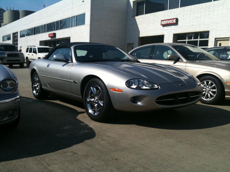

I had the local car I have been looking at inspected by a local Jag dealer. Results fair. No compression problems (in the 140psi range all across.) Here are the other items. The question I have is, what would you have done IF you bought this car? The turn signal stuff and minor stuff we can ignore for this topic, I can do that stuff. The mechanic mentioned replacing the cooling stuff, as it is leaking, along with the rear diff, and the rear shock. The rest is regular maint. According to the dealer, for $4500 the car will be in the clear and need nothing (for now at least).

Thoughts?
Dave

The "Fail" means it didnt meet inspection, (but could still be working)
Amazing! What year? Miles?
No mention of tensioners or suspension (?).
I cannot believe the cost quoted. Brake fluid flush $180? It would take less than half an hour to do that with a parts cost of $5. Turn signal bulbs $91.71? $1200 for hoses, thermostat?
My long standing philosophy is that these cars, especially the early ones are best owned by hobby mechanics. Other than the differential bearing/seal and rear shock there is nothing that couldn't be done by someone capable of changing a tire for 1/10th the price.

If a car I was looking at had all these probelms, I would run, not walk away from it. If you are determined, find a reasonable shop, the dealer is cleaning your clock. You don't say what car you are looking at so it's hard to help too much but even doing all this work doesn't guarantee the car will be like new, it could continue to come up with expensive repairs. One thing I will say, if the heater hoses are leaking, the intake manifold has to come out and this costs a few bucks to have done.
All other items checked out ok. I only listed the problem items above.

How much are they asking for this convertable out the door minus the repairs?
If the dealer has this car you may beable to negotiate all of this with the sale, The value of the car plus the repairs vs. this car sitting on their lot another day could be a good negotiating point. That is if the car is on a Jag lot.

All in all, a fair shake for an extra toy. Lot of car for the money I think. The car overall is in 9 out of 10 condition otherwise than listed. (few rock chips, etc).
Ive decided to buy it, knowing it wont be the end of maintenance. HAS to be better than the Ferrari and the boat I just sold....Plus you get the Vert...
Oh, and I was wrong the car is a 1999 with 64,000mi, and is a private seller. I just had the local dealer do a run through on it.
I appreciate all the feedback. VERY useful to me so thank you all!

The "mechanic" figures your a fool. $180 to change brake fluid?
The list overall is absurd in perspective.
You can be 100% certain that during the $180 brake fluid change he will announce your brake lines, rotors and pads are bad.
As he goes through your car, he will add dozens to many hundreds of dollars of discovered other matters.
The estimate is him recognizing you have no time, probably little knowledge and enough money to give him a few thousand believing then your car won't break down. It doesn't work like that.
It is so bad a list (and prices) I'd speculate he'd mess up parts of the car to insure you have to come back regularly.

The list of absurdities is long... $75 for wiper blades? Power steering fluid change $175? (but no transmission fluid change?)
How will you possibly know if he changed the power steering or brake fluid? In addition to absurd prices (and absurd list), he's not going to do it anyway. Just charge you for it - telling you more "must do" he discovers.
Having heard certainly over 1000 repair shop cases, I can tell you this is NOT a top-professional charging top prices. This is someone who operates on the PT Barnum theory - "there's a sucker born every minute."
