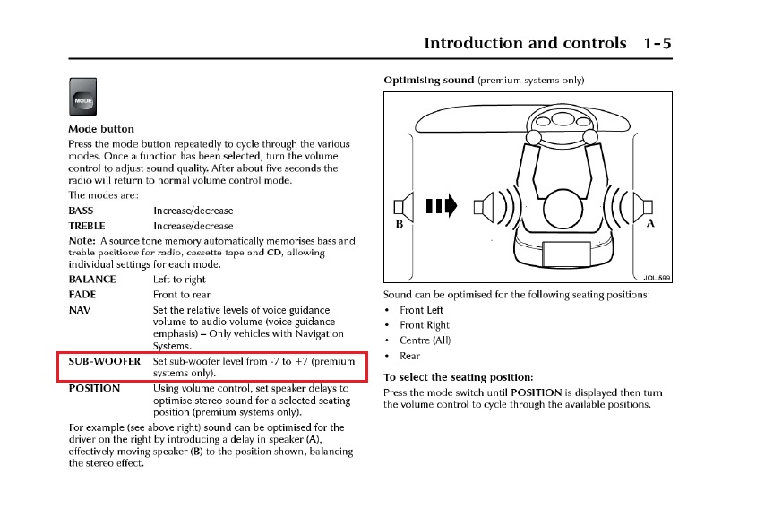

Bob,
I've added 'RESOLVED' to your thread title to help anyone searching for this answer in future. For completeness, here's the premium audio setup summary:
The Sub-Woofer ranger is -7 to +7 (see section I've boxed in red):
The POSITION setting is another excellent feature. The entire balance can be optimised for the driver to balance the stereo image.
