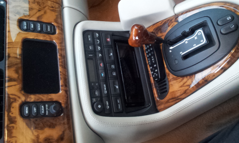

I upgraded the audio system with a new head unit and new speakers, replaced the aging navigation unit with a new one from Garmin that uses the factory monitor, installed both a backup camera and blind spot cameras which also use the factory monitor and activate with the turn signal. I started collecting parts for these mods last fall but was seriously delayed installing everything by some health issues. But, I got back on track after the first of the year when H2Oboy offered to help (thanks again Matt). However, before we could get started, I picked up a contract that required me to go to another state for several months (I'm still in Mississippi). Fortunately, this contract put me in close proximity to my business partner and best friend, who is also working an extended contract near me. As I'm sure H2Oboy can confirm as he did very similar mods to his XK8, these mods were not trivial! In fact, they were much harder and took much longer that I expected. That said, I am very pleased with the results.
First, the head unit; we installed a JVC KD-ADV49 Head Unit w/ XM Radio & Steering Wheel Controls. I selected this unit because I really like the way it looks, very factory-like. It also scores well on the gee-wiz scale! I had some help here from WhiteXKR (thanks again Steve) who was able to replace the internal microphone, which came with the KD-ADV49 unit but did not work well, with an external microphone, which works very well. WhiteXKR also helped with the blind spot camera system by wiring up the cameras to a video thing-a-mi-gig to make them turn on with the turn signals. WhiteXKR also installed the ambient light sensor from a spare XKR mirror into an aftermarket mirror with a video monitor that I had bought. However, I ended up not using that mirror and wired the cameras into the existing navigation screen. This worked well and was a little easier to install. I also installed a switch so that I can still see my Jaguar clock on the nav screen when it's not being used for anything else. One issue here however and a question for H2Oboy: how do you set the time on the clock?
Next, I installed a Garmin GVN 53 Navigation Upgrade on the Original Nav Screen. This is the exact same mod performed and documented so well by H2Oboy. Works great and the remote control is very easy to use, you don't even miss not having a touch screen.
The blind spot camera idea is new, at least I don't know of anyone else who has installed such a system, and came to me when I was having difficulty turning my head to check my blind spot as a result of the health issues mentioned above. I did find an aftermarket RADAR system, similar to the factory systems that are installed on some new cars today, but I liked the camera idea better. I have a camera installed on both corners of the front bumper that point backwards at about a 45 degree angle. It works very well.

Well done! And the audio install looks great...nice and clean.

Hey Mark, looking good! Put a $10 supermagnet behind that cradle and a washer in the battery door of the remote, and that baby won't budge from the thing.

Nice work !
The head unit is the weakpoint to the interior of the interior, in my opinion. Apart from that, I love it - even more so than the later XK interior.
Anyway, how did you do the flush-curved bezel to the headunit ? That looks superb.

It's off an older XJ; there's another post here that gives the part number. As for the head unit, I like it. It tilts, has interesting touch controls and the screen is easy to use. Plus it works with the steering wheel controls.

Mark. I did like the reverse camera AND the turn signal view in the NAV screen. I was REALLY impressed!!!!! The system you have is everything that the factory system is lacking.

Thanks Bob, I just need to turn up the brightness; there is an adjustment on the PAC Video module but I haven't gotten to it yet. That said, I was very pleased with the way that all worked out. Thanks again for your help.

Several members have asked about the blind spot cameras and where I got them. Originally, I had bought a couple of other cameras off eBay but when it came to installing then, I just could not find a good way to mount them. After some research, I ended up with the cameras shown in the photos above and after about a month of use, they really work great. I am very happy with this mod. Today, I finally located this info on these cameras, so, if anyone is interested these are the cameras I used:
Accell, RVC1150L and R and they only come in black, so you have to paint them to match you car.
I ordered them through a local car audio shop where I had other work done, if anyone wants that info, please pm me and I'll send it. I talked to Chuck (the owner) and he said if anyone is interested, you can order these parts through him.
