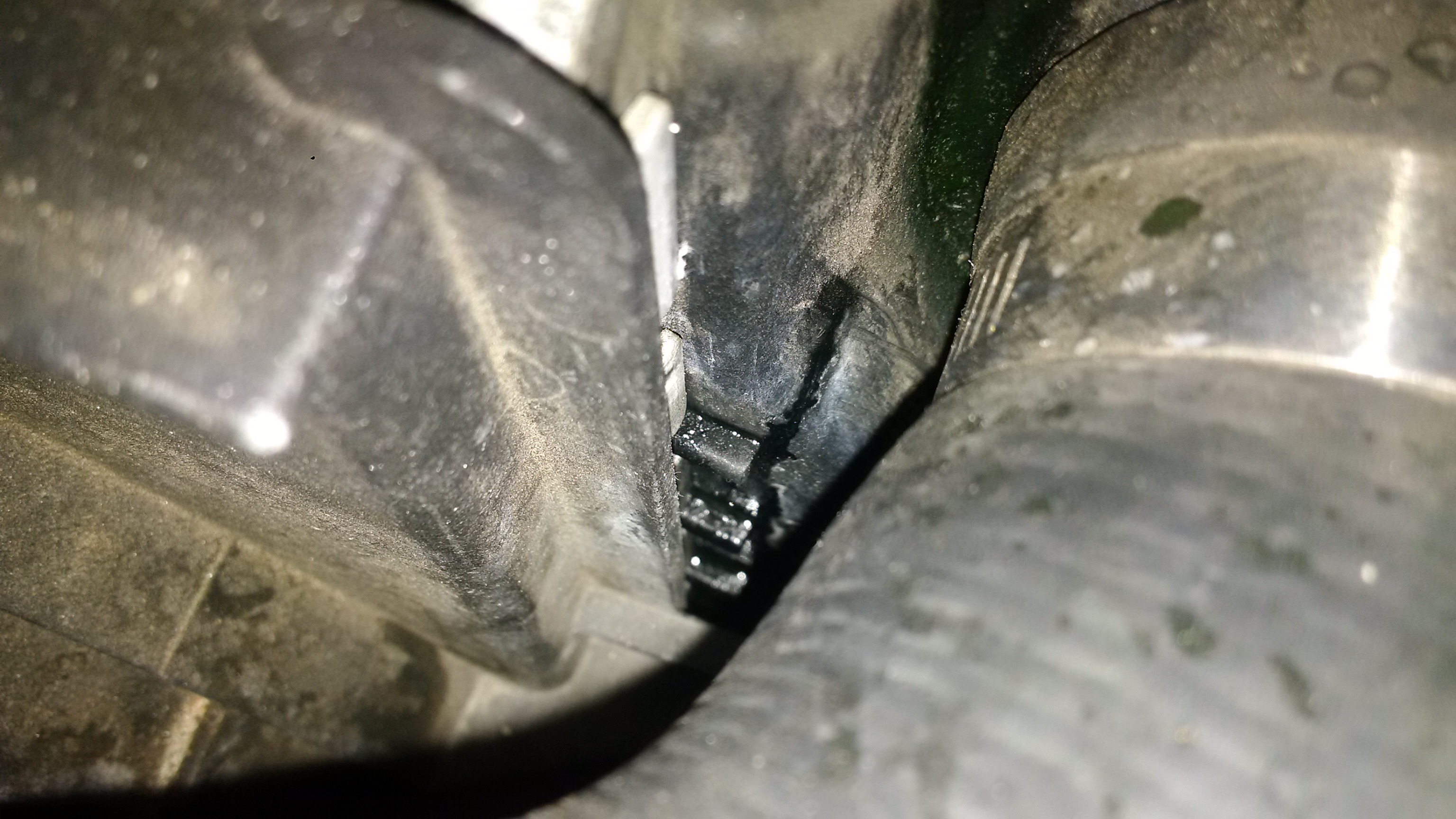

The other day, I received the Coolant Low alert on my way home from work, temp was reading 201 via Torque Pro. Immediately pulled over and shut car off - no visible indications of leak anywhere that I could see.
I let the car sit for a while, then filled the reservoir, started the car and again looked for any tell-tale signs of leakage but nothing, not even the smell of burning antifreeze like I had when the valley hoses and octopus hose went south. Not even any puddles.
Today I checked the coolant level and slightly down but no puddles under the car. Started her up and went looking again and just under the radiator, noticed a drip - think I found my leak . Pics are a little hard to see but passenger side of radiator appears to have a leak.
so - any thoughts on using a bottle of the Liquid aluminum radiator stop leak until I can source a replacement radiator?

Are you sure you don't have a bad radiator hose at the connection to the radiator? At running temp is is leaking down the side of radiator (due to heat is drying out) but gets to where it is sitting that you can see it???

Tim - I felt around the hose connection and it wasn't wet but the upper/lower rad hoses are the only hoses I haven't replaced. I will see if I can get a better picture of the area.
The wet area is about 2 inches down from the upper hose connection

Looking at the picture, that is not an original clamp so someone
has already been there. The hose looks squishy. Since a new
radiator would involve a new hose, maybe that can be your
first stop.
In fact, you might try removing that end to get a better look,
clean off the connection and reattach the hose. Careful not to
overdo it on tightening the clamp.

started car and let get to temp - found the culprit - indeed the radiator at the seam

Nice pretty GREEN coolant
At least it lasted 15 years. I hear that on BMW's
radiators are a maintenance item.
