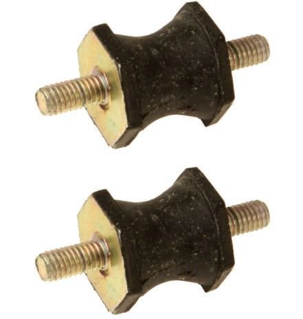

From memory, this K&N panel is a simple swap. If, during the swap, you feel like cleaning things a bit, pay attention to these rubber-stem mounts holding the lower section of the air box. If you apply torque to the nut, that torque is applied to the rubber body and it can shear off. Make sure you hold the back side (a hex plate) with a wrench. These "instrumount" are insanely expensive from Jaguar (and just below nauseating from the after market).

Originally Posted by fmertz
... pay attention to these rubber-stem mounts holding the lower section of the air box. If you apply torque to the nut, that torque is applied to the rubber body and it can shear off. Make sure you hold the back side (a hex plate) with a wrench. These "instrumount" are insanely expensive from Jaguar (and just below nauseating from the after market)....
I bought these off ebay for $7 a pair w/free shipping.
yes, these are a match for the originals. i purchased the same a while back, fit perfectly.
