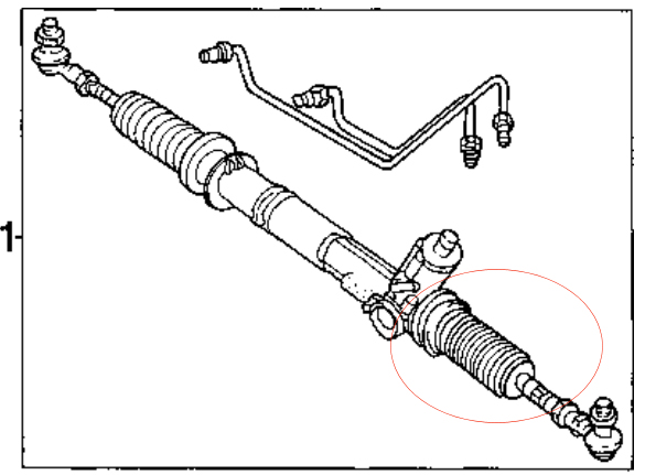

Inner/outer, I get them confused sometimes, I did mean the one out the between the steering rack and the tie rod end, connection under that boot. I knew we were talking about the same thing though.

Yep the part circled in red. I wonder why they don't list a part if it is available for the S-type and they are interchangeable? I did find out that the rack is the same between XK8, XKR and XJR, but NOT the XJ8.
No, to service the rack you don't have to touch the fluid reservoir other than to take the cap off to add fluid when you are done.
I think I did find the answer to that question though digging deeper into the JTIS description and operation section on the Steering. It seems the power steering reservoir has a filter in it. I assume they want you to replace it after any major work to have a clean filter...
