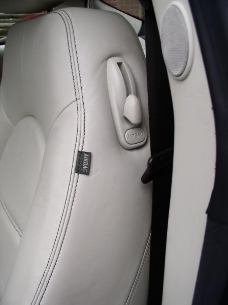

In my experience (Well, both my XK8 and X Type!), the seats are identified as having airbags with a small black tag sewn into the seam that says 'Airbag'. Tag is visible as soon as the relevant door is opened.
Old Sep 5, 2012 | 05:53 PM
+1
And the seat tilt lever also has 'Airbag' moulded into it:
Attached Thumbnails Quick question: Does the 2000 XK8 Have seat airbags? RESOLVED-airbag-tag.jpg
