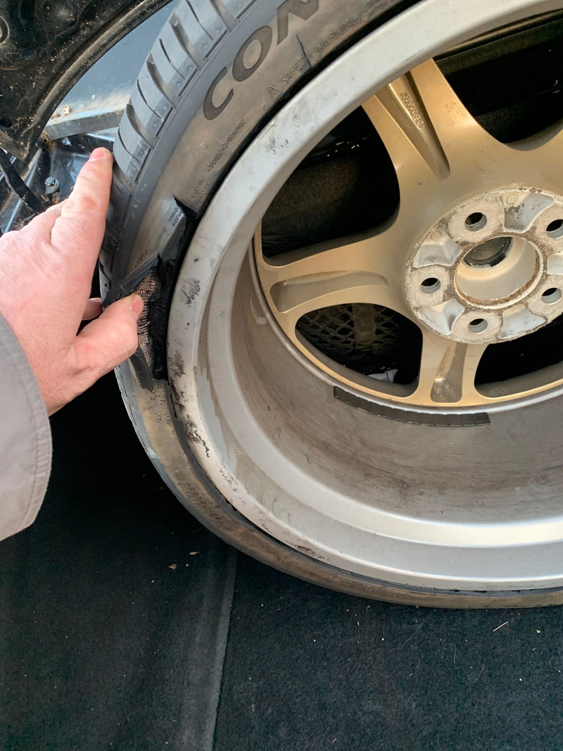

Hit a pothole and either unseated my tire or tore it. Regardless, its shot now and my new trim ring has a slight ding.

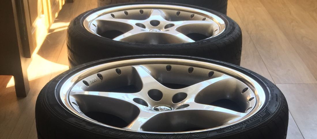

2}. I think you could get away with 295’s which will be just 10mm wider but the ideal solution is to get tyres with thicker sidewall moulding (see pic). These are designed to protrude beyond your wheel rim for added protection. Different Tyre manufacturers have an acronym for it; MFS – Maximum Flange Shield, FSL – FelgenschutzleisteFlange Shield, FR - Flange Rib, RFP - Rim Fringe Protector, FP - Fringe Protector.

Thanks. I'm familiar with the factory size and what the numbers mean. I actually didn't know there was a rim flange protection rating all though I've notice certain tires definitely have more of an overhang. Unfortunately with these the trim rings can get damaged by the tire itself.
My thinking with the 295 is that Both the extra sidewall and width although minimal, will help. I'm sure someone tried fitting this size. I know it will be fine on the time just don't want it running anywhere. As far as 19"s I have them on my other xkr as I didn't want to go with 20's this car however is stock and I want to keep it that way.
