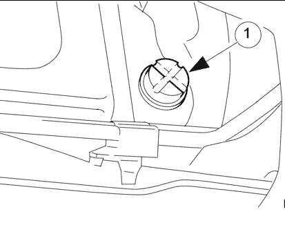

It's at the bottom RH corner facing towards the engine:
A black plastic plug in a black plastic radiator so not the easiest thing to spot. You'll only get to it from beneath the vehicle.

Remove the plastic guard that ties into the Radiator support first. It makes the plug easier to spot on the lower right side of the tank. It sits flush with the tank and you can get at it with a long flat blade screwdriver. I backed the plug off a couple of turns and that was enough to drain the coolant. It looks pretty near impossible to get your hands up in there if the plug came all the way out.

It IS accessible from the top. Figure out where it is from below, then reach down to it with a large washer or U.S. quarter Dollar in your hand as a tool to loosen the plug. The slot orientation allows you to make 1/4 turns without dropping your tool. A cat litter box (without the litter) makes a good catch pan for this job. Make sure that the seal on the plug is good before you put the coolant back in, or you will get to find that plug again.

Appreciate it. I had good luck today, once I used the appropriate tool reaching from above (arm between the air box and heater hose). The big 'tool' on the the left was the useful one (large thick brass washer), not the first one I tried, the little one to the right. The plug came out 'easily' in the sense that it came out without breaking. I could not open it with the US quarter from the top. But the thick brass washer gave more leverage, and I didn't get under the car at all. Drain, water, run for 10 minutes, drain, distilled water/radiator flush for four hours running/driving, drain, distilled water, run for 10 minutes, drain, distilled water, run for 10 minutes, drain, concentrated coolant, run for 10 minutes, drain, coolant, . I probably would have left the flush for a few days if it wasn't going down to -4 C (25 F) tonight and tomorrow night.
But, I had replaced a large fraction of the coolant during the 'leaky' time and when I did the new thermostat stack/crossover/valley hoses. So what remained of the original mixed crap was apparently almost nothing, and the flush was unremarkable, even for often unremarkable aluminum systems. Appreciate all the help.
Good tool to the left, bad tool to the right. There's probably an even bigger thick washer that would be even better.
