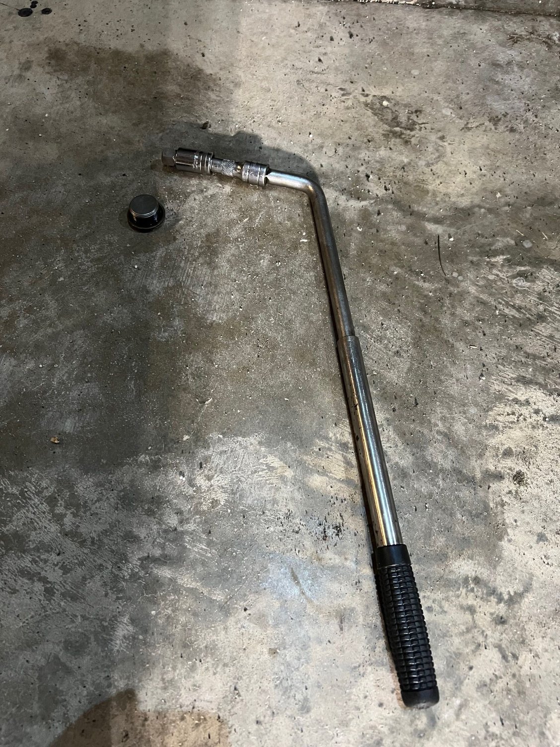

From: Pensacola, FL

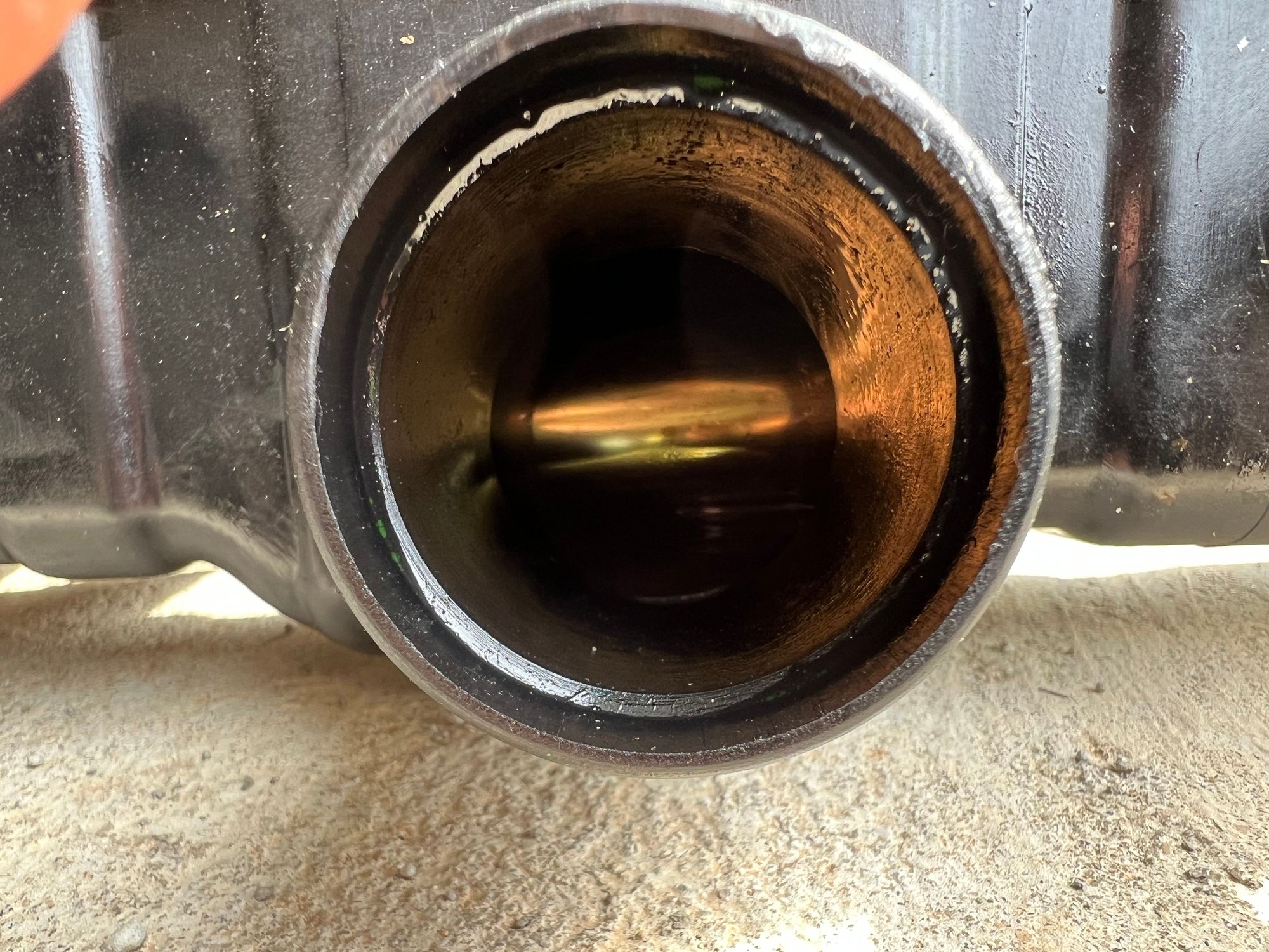

Default Removed block drain plug and drained transmission pan

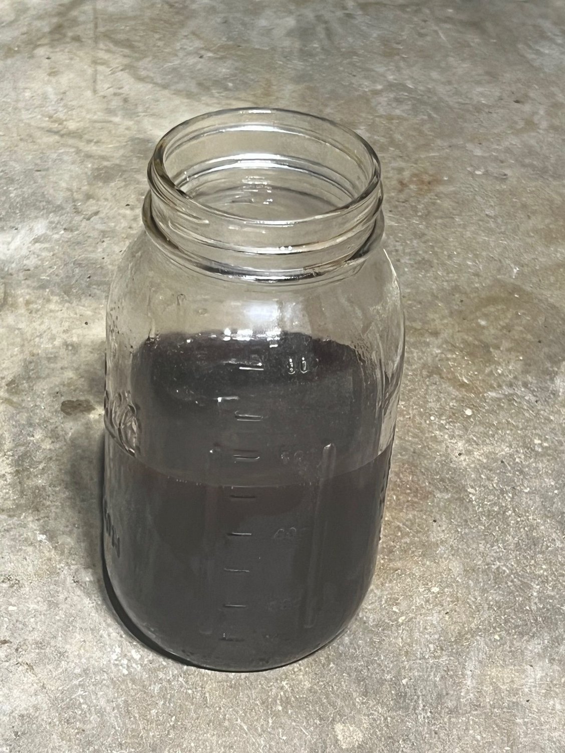

Removed block drain plug so going to flush with hose water. Once closed up and radiator hooked up will flush with distilled water. When drained transmission pan only about a pint came out. Coolant is denser than transmission fluid and no coolant came out first. What came out looks coolant free. Letting jar sit overnight and will see if any coolant separates out. Planning before hook up trans lines to cooler I'll run with two lines connected by a clear plastic tube and see if looks good. If I'm thinking about this right, the transmission pumps fluid to the radiator but doesn't suck it back in. Because reservoir cap was off no pressure to force coolant back into transmission.

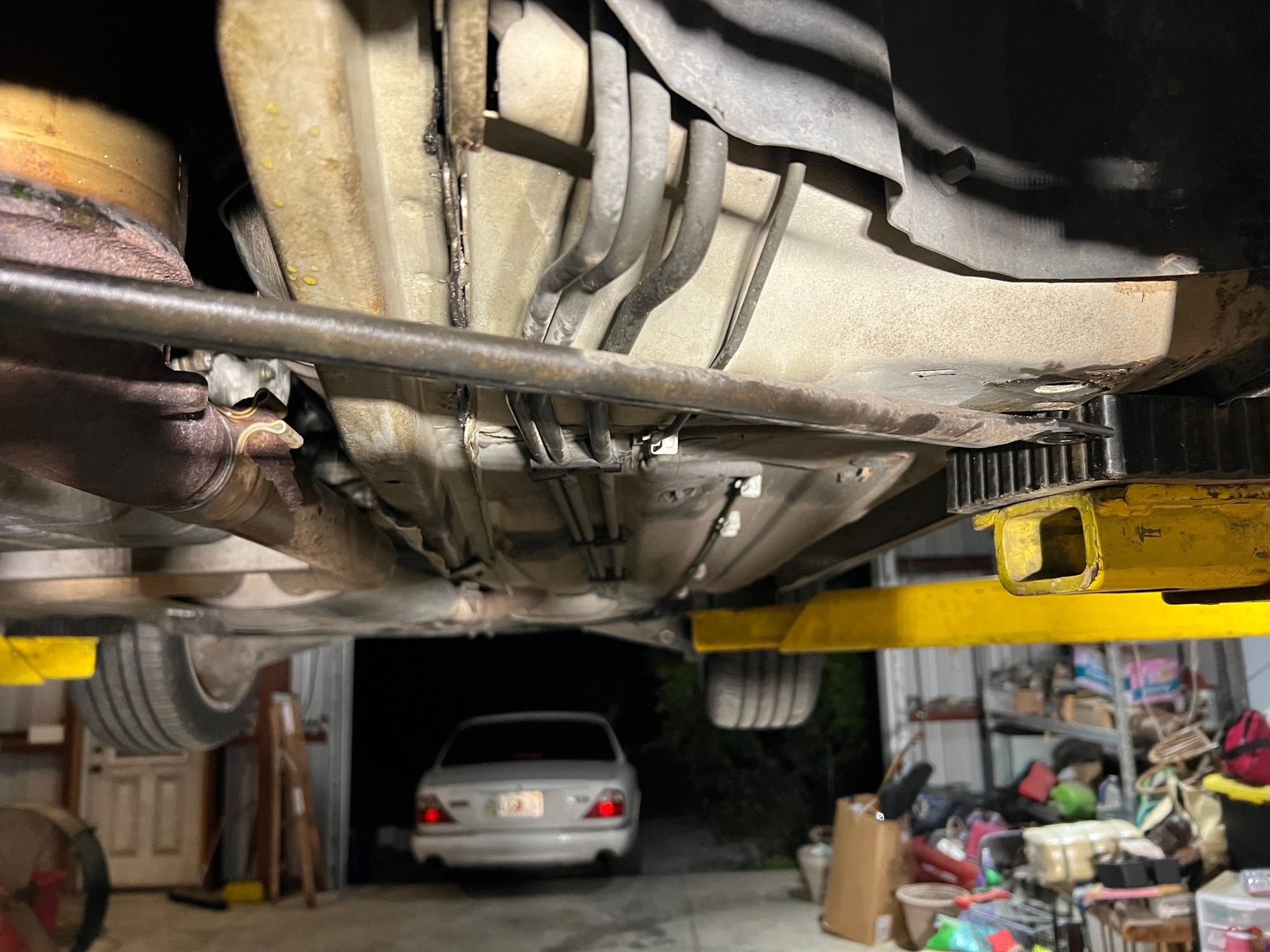

Convertible so has X support.  Disconnecting aft bolts gave just enough room to rotate breaker bar to loosen.

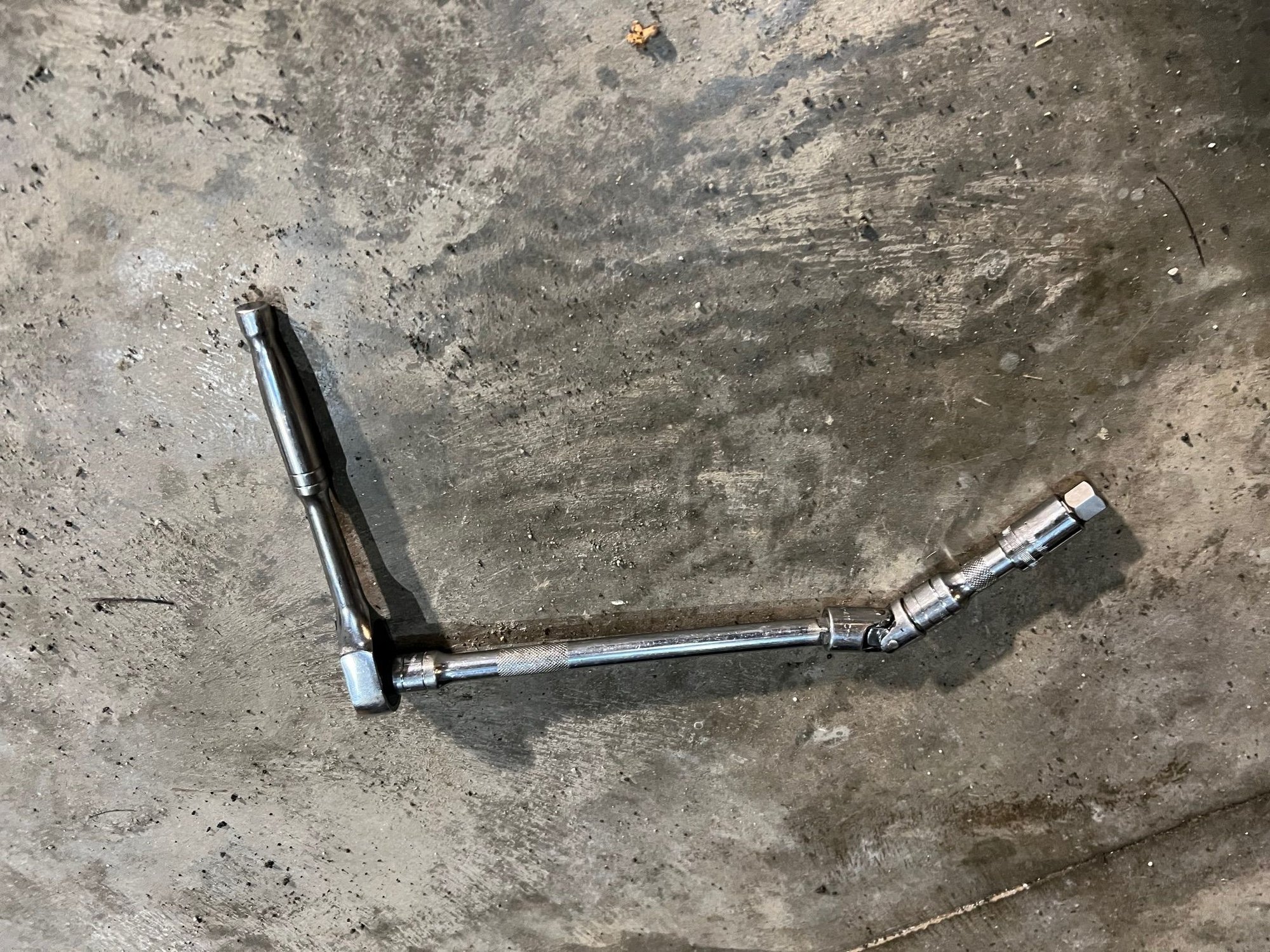

Used this to break loose.  Really hard to fit in ratchet and extenders in tight space.  Luckily had this wheel leg breaker bar.
Once cracked drain plug used this setup to remove.

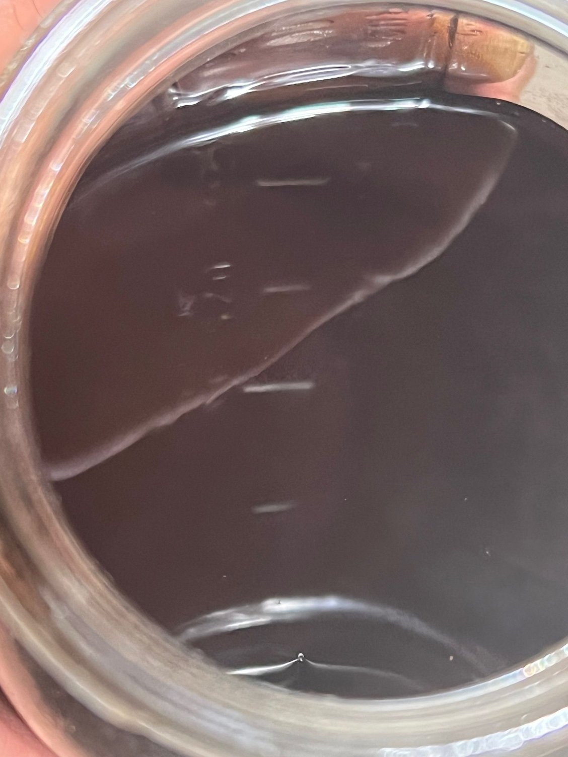

All that came out of draining transmission pan.
Doesn't look like any coolant in transmission fluid.
Old Apr 18, 2025 | 06:05 AM
bladerunner919's Avatar
Joined: Jan 2016
Posts: 1,075
Likes: 546
From: Berks, UK
There was probably more pressure in the trans fluid than the coolant, so likely that the flow was all one-way. Which is better for you, as flushing the coolant system is a lot easier.
