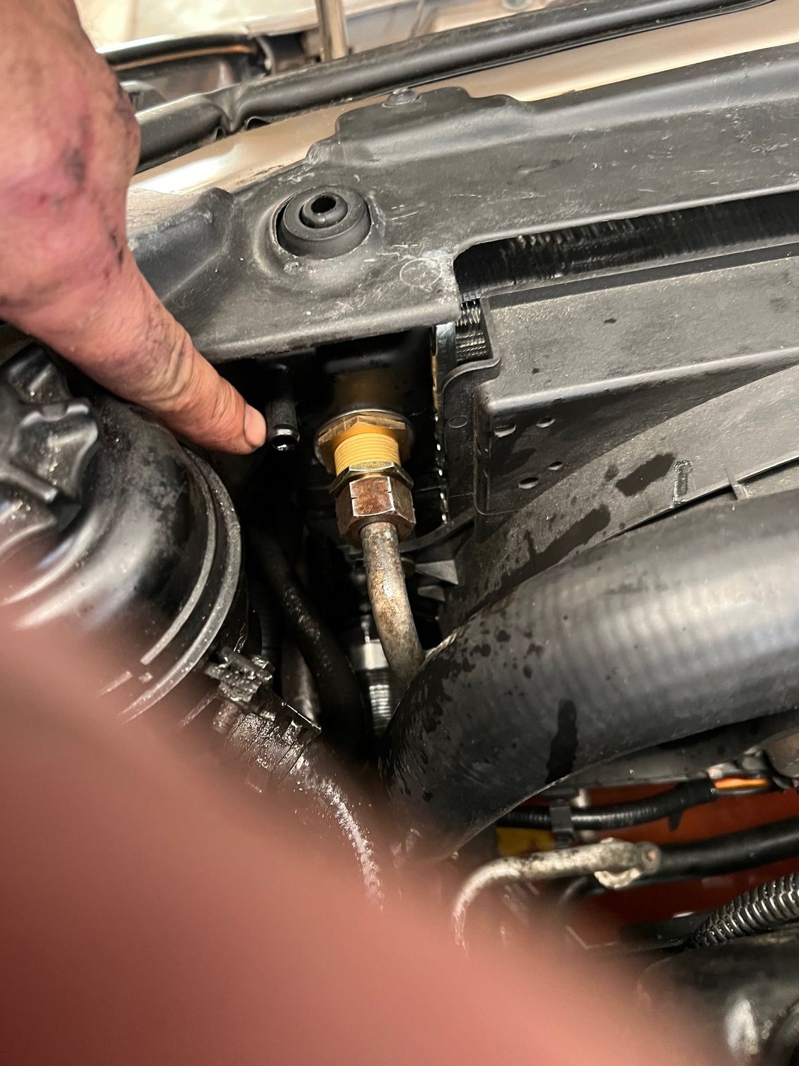

Yes, it is a Nissen. Replacement went pretty smooth except for breaking loose transmission coolant line nuts. Fill with coolant and start. Poised to add coolant at reservoir as sucked in. Within a few seconds coolant comes out of reservoir like Old Faithful. Shut done immediately. Dumbfounded until see transmissin fluid coming out of outlet in picture. Unlike XJs, on XKs this outlet is suppossed to dead end. No instruction packet came with radiator saying needed to plug. Actually kind of good this open pathway existed as immeditaely told me what was up. Opened thermostat tower and transmission fluid there. Figured eruption happened after initial coolant in system and transmission fluid totally filled system.

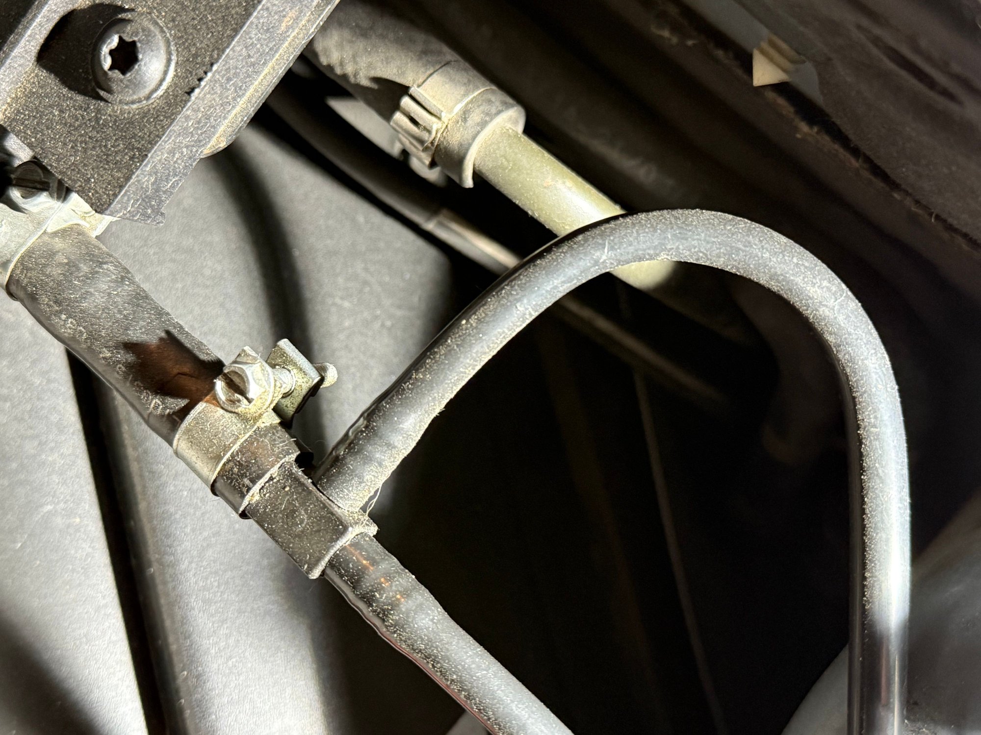

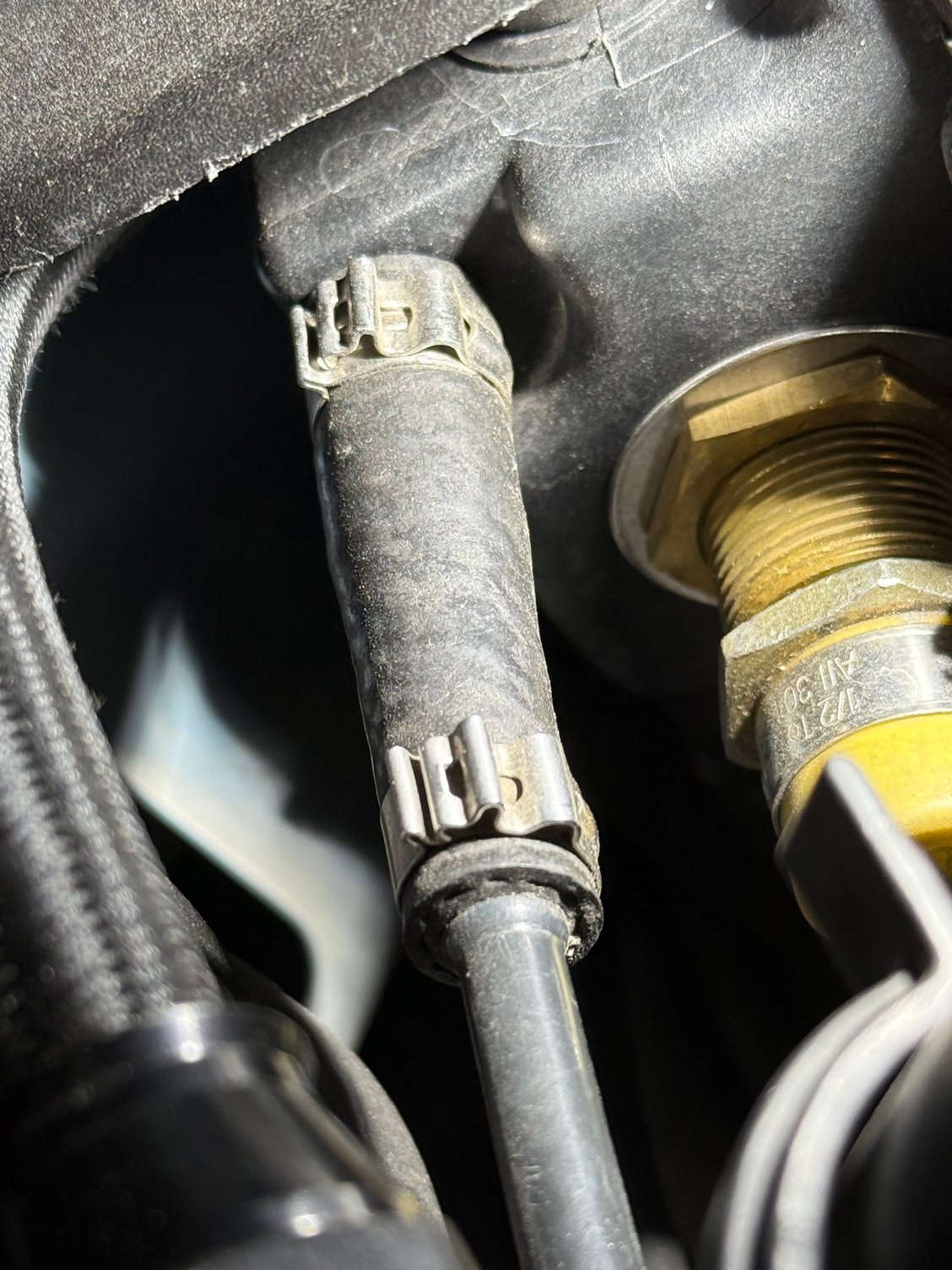

not a dead end on 4.0 XKR’s
on the XK8’s it might get plugged, it’s active on my 2002 XKR.
Radiator end
Radiator end
Where the same line goes into the reservoir.
Where the same line goes into the coolant reservoir.
Z

sounds like you received a faulty radiator if the trans cooler leaked into the radiator and vendor should replace
I used these and a tie wrap to cap that off - been holding steady since I replaced the radiator several years ago. This used to connect to the expansion tank but they did away with it for some of the models.

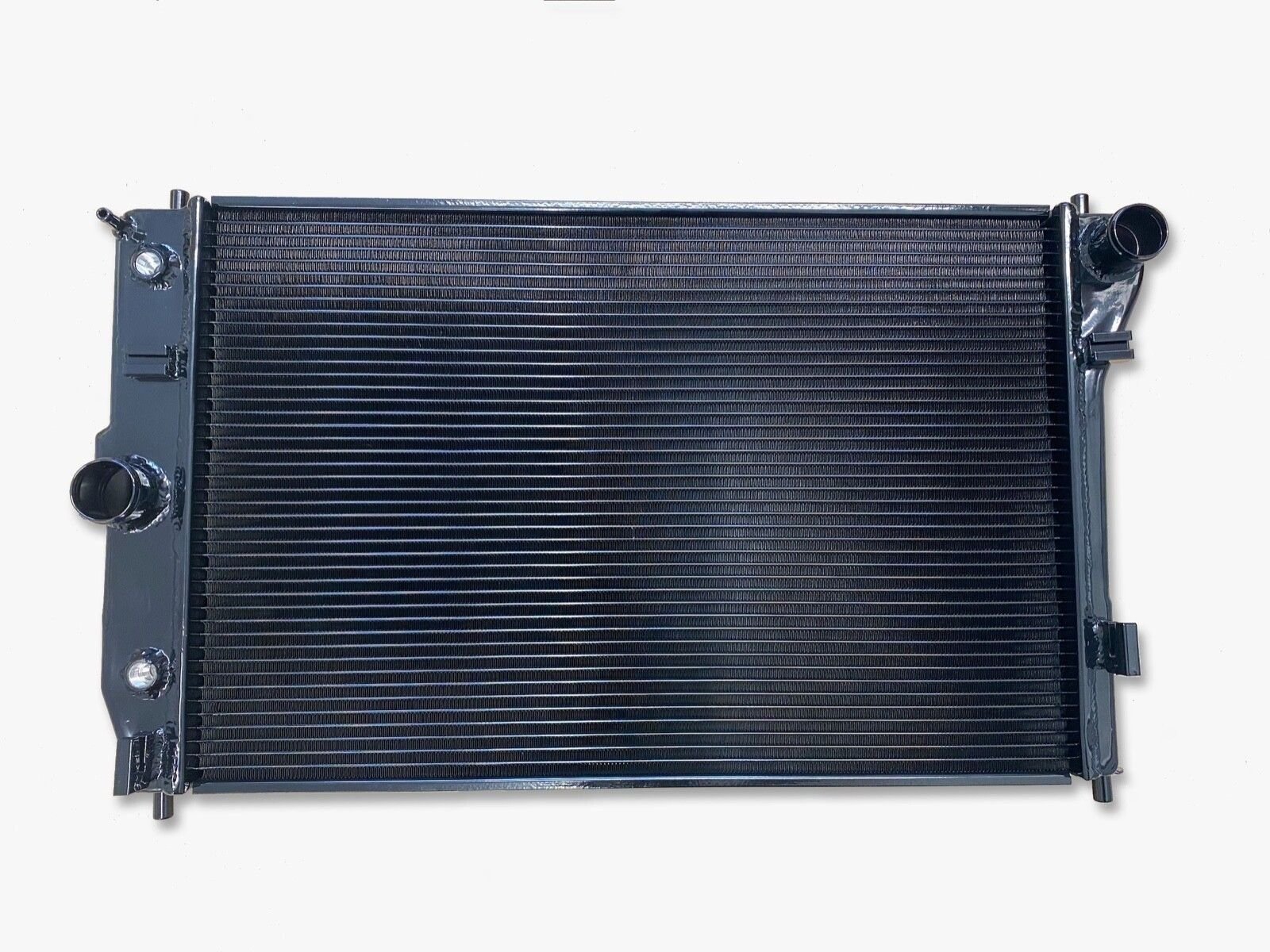

Here's an all aluminum Aston radiator: https://www.ebay.com/itm/194991020119
$890 on ebay

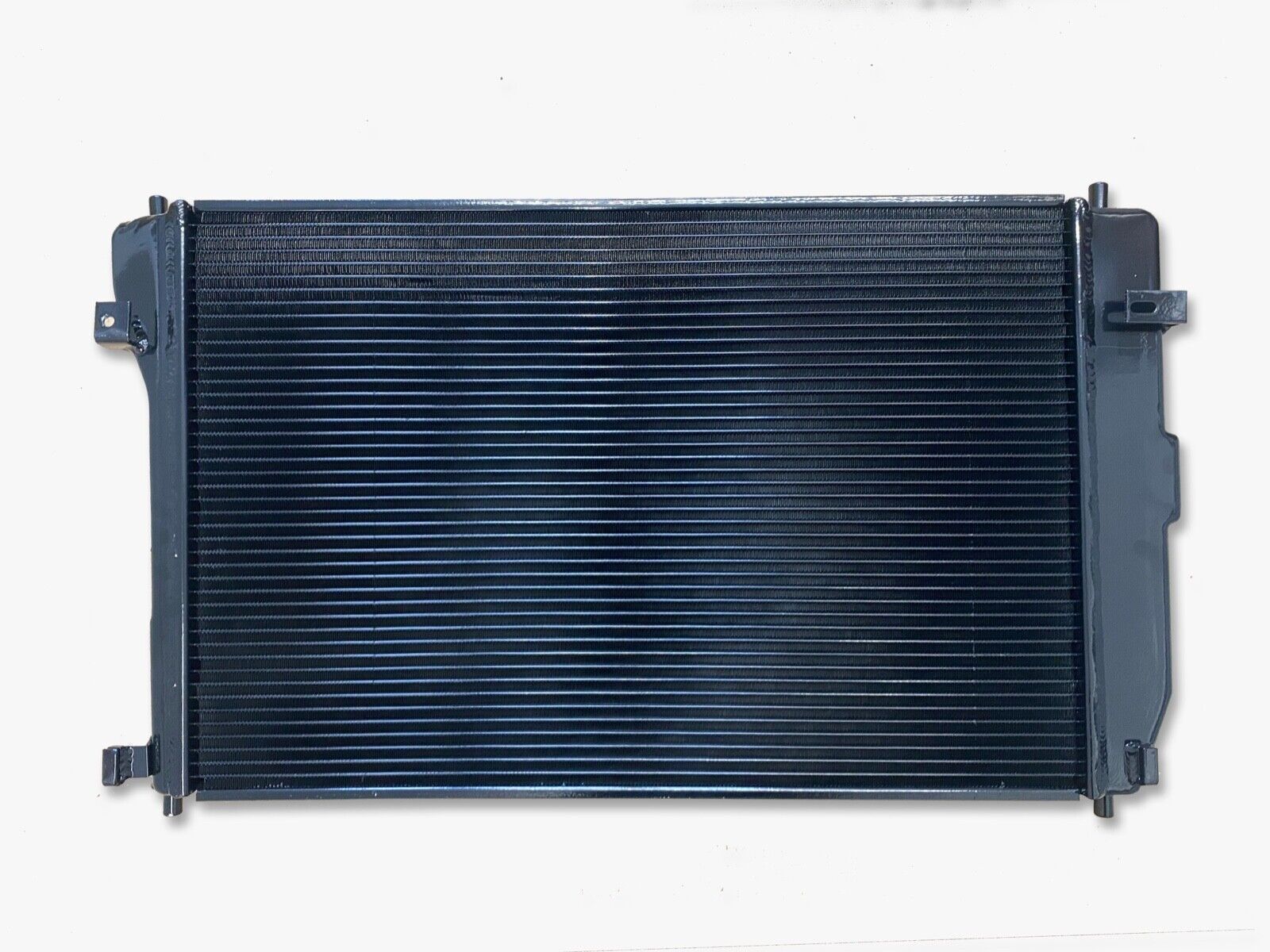

Ebay All Aluminum Aston DB7/DB9 Radiator Engine side
Ebay All Aluminum Aston DB7/DB9 Radiator Bumper side

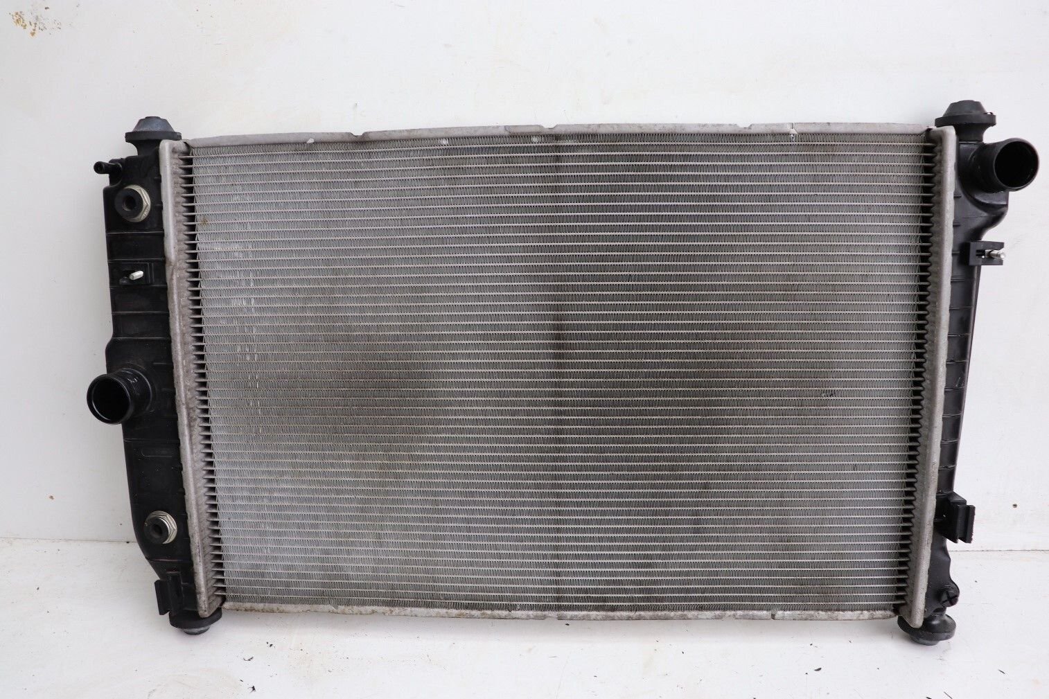

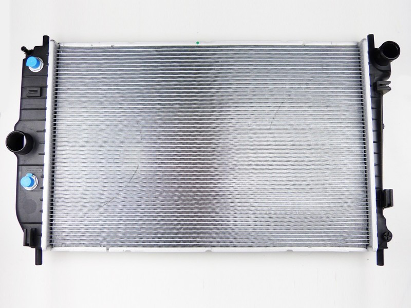

OE Aston Radiator (Plastic End Tanks) Engine side
OE Aston Radiator (Plastic End Tanks) Bumper side

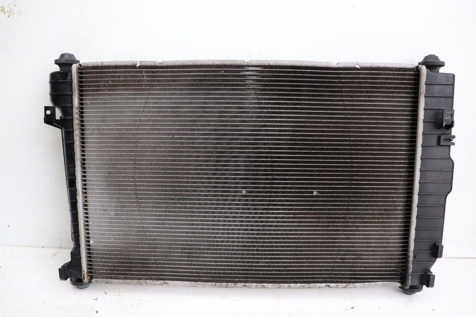

OE Jaguar Radiator Engine Side
OE Jaguar Radiator Bumper Side

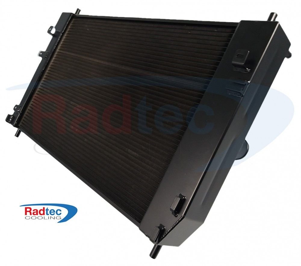

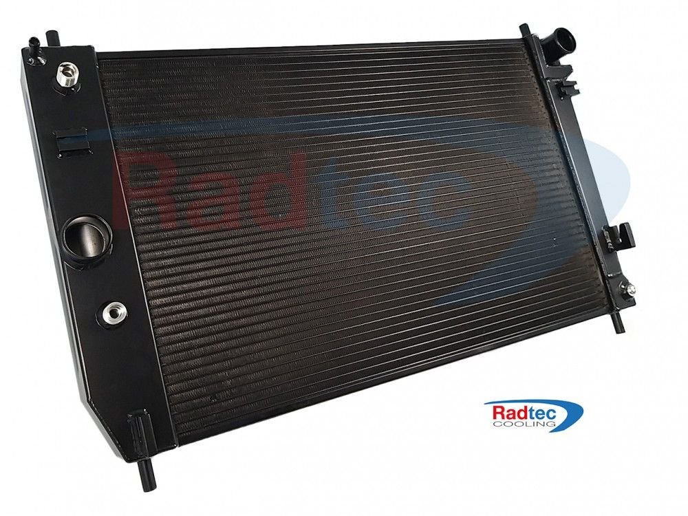

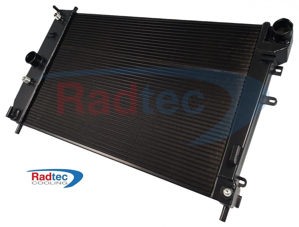

Radtec All Aluminum XK8 and XKR Radiator Engine side

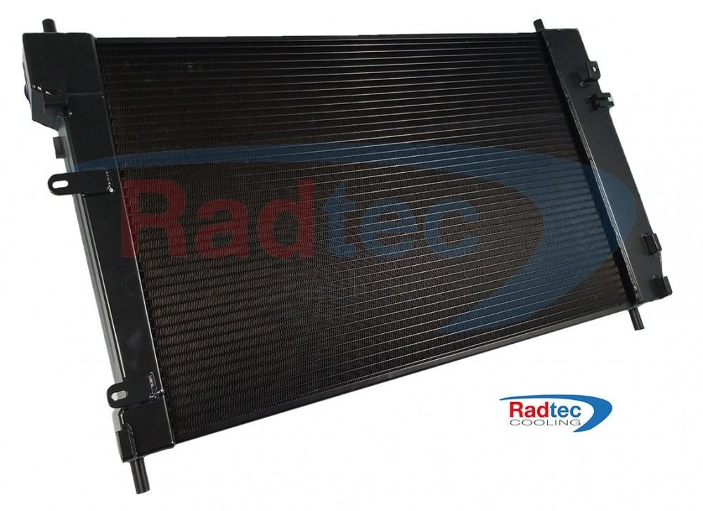

Radtec All Aluminum XK8 and XKR Radiator Bumper side
So, in summary, I think the Aston Martin can be an almost directly fit. You may just need adapters for the transmission cooler lines. I think the Nissens radiator you bought came with the adapters you need because it might possibly be the same part as the one they sell to the Aston folk. There's only one dimension I can't visually tell in all these images and that's how thick the radiators are. They may very likely be the same thickness. The only other difference I can see between the Jaguar radiators and the Aston radiators are some mounting tabs on the bumper side for a bracket. That bracket, if I recall correctly, has the purpose attaching the radiator to the A/C condenser. You might be able to get away without that bracket? If not, weld one. It doesn't seem complicated.
IF you can find an all Aluminum Aston Martin Radiator for less than the price of a Radtec All aluminum radiator then that's most likely the best option on the market.
Here's the link to the Radtec radiator: https://www.radtec.co.uk/shop/makes/...xk/jaguar-xkr/
Here's the link to the Aston Alluminum radiator I found: https://www.ebay.com/itm/194991020119
If you decide to get a refund on the Nissens radiator and want to try either the Aston Martin or the Radtec radiator, please report back to us. I think you'd be the first to try either option and it would be a great contribution to the wealth of information on this forum about the fit of either of those radiators.
