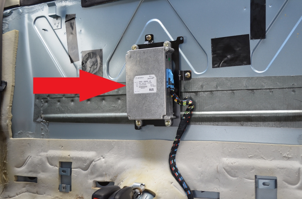

I have an 04 XK8 Convertible LH drive and I typed my VIN in.. The system said the radio is compatible with the iPhone 4 but my radio says "NO PHONE" when I press the phone button. I'm guessing the website won't tell you if you have the bluetooth module installed from the factory?

All XK8's have the phone controls but only a few have Jaguar Bluetooth fitted. It was an expensive option. Any Jaguar Dealer can lookup the original build specification from your VIN and confirm whether you have BT fitted or not.
Alternatively, just take the rear seat out and check if there is a module fitted:

Originally Posted by GGG
Welcome to the forum nrodgsxr,
Wrong forum for your model. I've moved your post from XK/XKR to XK8/XKR forum.
Attachment 206599
wow thanks you really know your stuff. Ill call my dealer tomorrow
