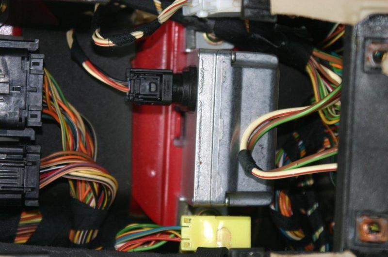

I just read your pdf with interest, confused by a conversation earlier today with a local Jag dealer who stated that there was no bluetooth capability for my '03 XKR, yet your document suggests 2003>2006. I have taken the center console/armrest top off and see at the bottom center of the pix there is a unused yellow connector that presumeably allows said hookup but I am unclear as to what part number I should order for this adaptation?

Jaguar have never been entirely at ease with new technology and generally lagged behind other manufacturers in adopting. When they finally adopt, it tends to be already outdated.
Bluetooth is an example of this and their installation is barely adequate. It was offered with the introduction of the 4.2 in the UK but appears to be a rarely requested option. The reason for this is probably the small number of compatible phones and the unreasonable additional cost from Jaguar.
I can find references to earlier fixed Motorola installations being made available later for the US market but no similar information for Bluetooth. However, I've no doubt the dealer is correct and it was made available later than 2003 in the US.
The yellow connector in your pic is for the telephone but is likely to be for the earlier fixed type. Confusingly the same connector is used in both. Here is my 2001 which had been butchered by the PO for an aftermarket phone install. (I tidied this up and fitted Parrot CK3100):
And this is my 2005 with Bluetooth fitted:
The same yellow phone connector is used in both vehicles.
If my present XKR hadn't had Bluetooth, I definitely wouldn't have considered retro fitting the Jaguar equipment. I had removed the CK3100 from my earlier XK8 ready to fit to the 2005 before I found it had Bluetooth.
Jaguar Bluetooth pairs with a restricted, and largely outdated range of phones but the biggest downside is it can only be paired with one phone. If you have more than one phone, it can't be setup to pair with whichever one it finds - you have to go through the whole pairing process each time.
The yellow connector can be used to connect better aftermarket Bluetooth than the Jaguar system.
Attached Thumbnails XK8/XKR Bluetooth - phone pairing-2001-telephone-connector-socket.jpg   XK8/XKR Bluetooth - phone pairing-2005-cubby-box-liner-removed.jpg

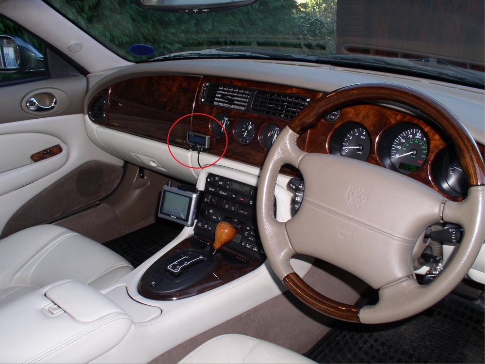

I fitted Parrot Bluetooth CK3100 in my 2001 XK8 which was the last model I had without factory Bluetooth:
CK & MKi Ranges - Parrot USA
It was low cost, a reasonably neat installation (circled in red) and reliable.
If I was looking for an aftermarket solution now, I'd be going for the one with phone and audio combined. Technology moves fast and members may be able to advise other options.
