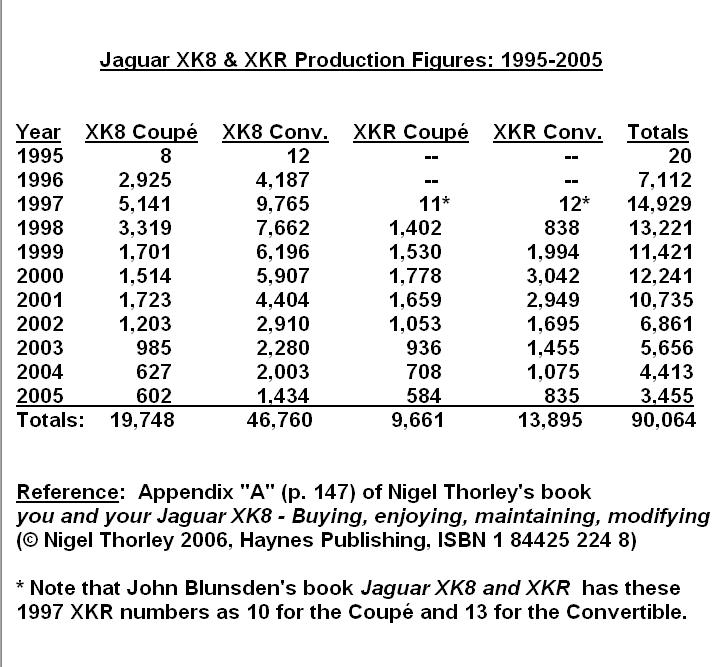

A little googling I came up with the production numbers for the 3 series BMW from the same time period as our XK8s and Rs.
There are roughly 40x the number of BMWs 3 Series as there are Jaguars XK8s and Rs.
Assuming that the percentage of enthusiast who would want to tune a car is similar (which it likely isn't) then we should nominally expect to pay 40x the price of the BMW tuning solutions.
As was stated before, it isn't that it can't be done but simply that most of these large tuning companies are, at the end of the day, businesses and they have determined that it isn't worth the effort to go after the market.

I understand the thinking that the production numbers of XK8/R versus BMW 3-series would make it look like the "effort" to develop a program was not worth it. However you really should weigh in the engine itself in terms of potential market. Didn't other models also use the 4.0 and 4.2 engines? Similarly, yearly Corvette C4 yearly sales numbers were not all that high (in the 20,000 range) but a variety of programming devices were readily available--likely because the LT-1 engine was also used in other vehicles.
I would think that the popularity of the latest gen XK might have generated more aftermarket companies who would also find it profitable to develop items for the old gen models.
