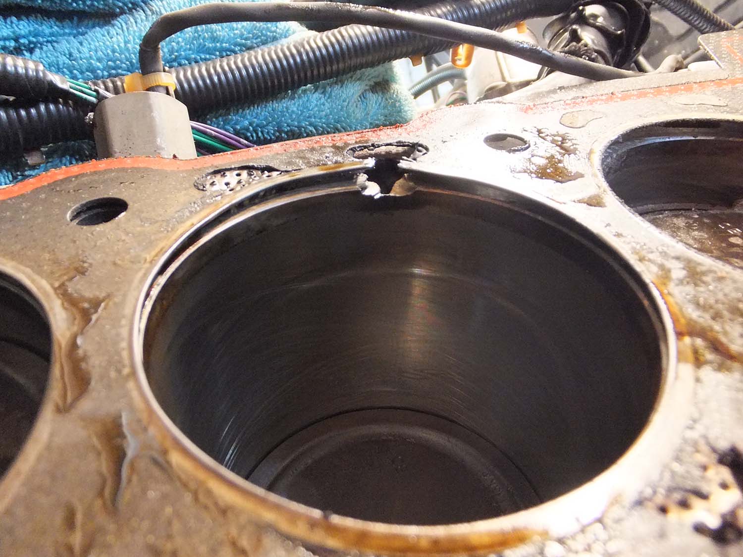

This rebuild I am using a 4.2 litre block (forged) plus Carillo pistons, 650 - 750cc injectors an exhaust header system and hopefully a fully programmable ECU
the attached photo is one of the destroyed blocks
