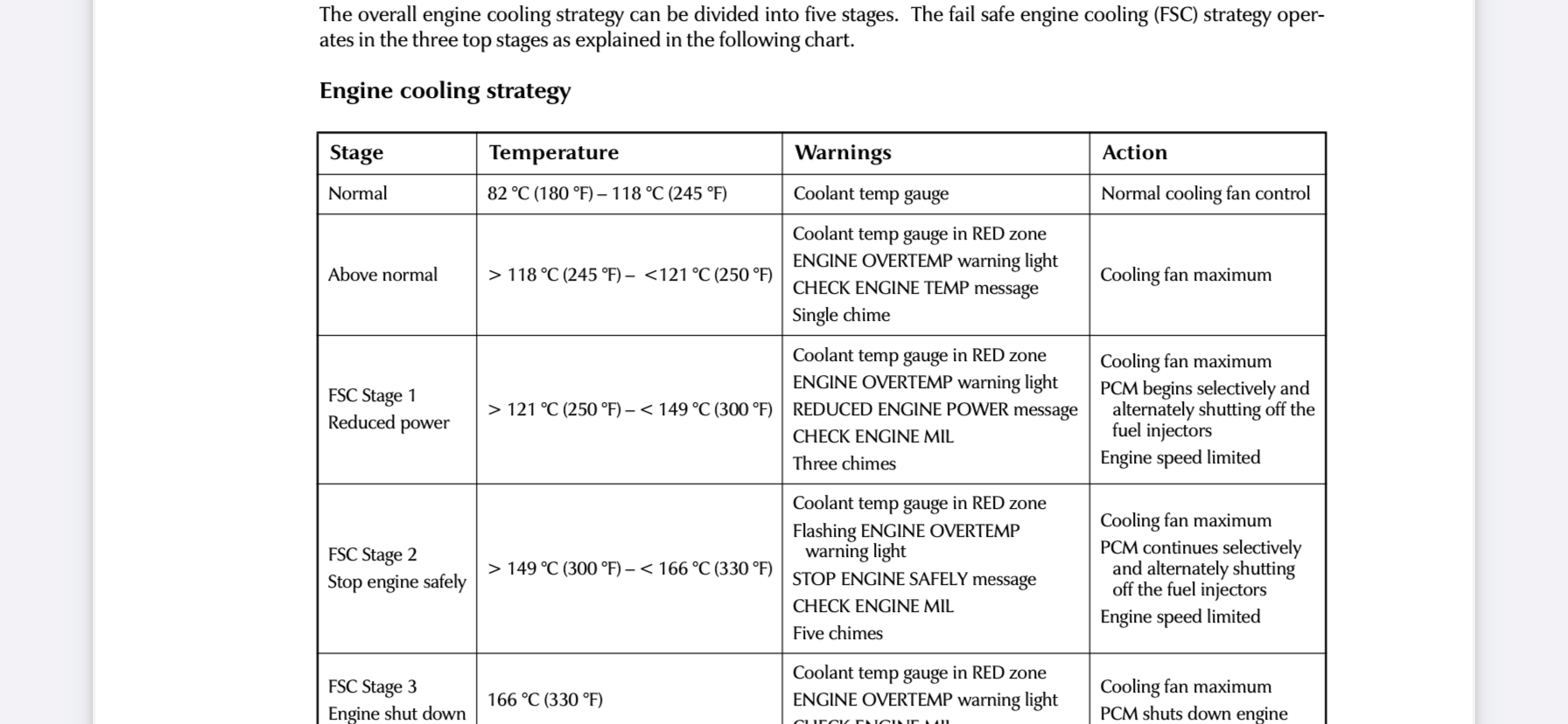

The cooling fans never went on in the car. I had the car running for around twenty minutes prior to a fifteen minute test drive....didn't notice them running when we got back. Lw coolant light was on. Further....Should they not go on when the A/C is turned on? On my subsequent visit a week or so later I purposely turned on the AC....I felt the compressor engage, it was only 45 degrees out and I wasn't interested in running the car very long.....
Obviously I'll have the techs test them when I call for an update tomorrow but good to know before hand if there is a potential issue.

Yes they should, at least they do on my 2002 XKR.
I believe that applies to all the years of the X-100, someone more knowledgeable than I, and there are many thusly designated on this forum, please chime in if I’m mistaken on that….
