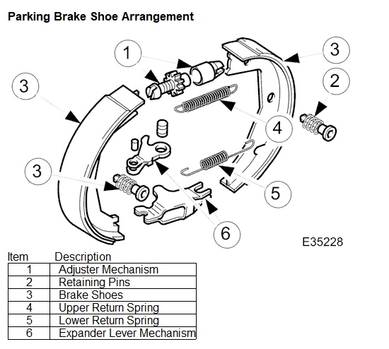

Seeing a diagram first often helps before you crawl under the vehicle.
Rear Brake Pad Replacement/Recalibration-parking-1.jpg
Rear Brake Pad Replacement/Recalibration-parking-2.jpg
If you are only changing rear brake pads, you won't disturb the parking brake assembly or its adjustment.
