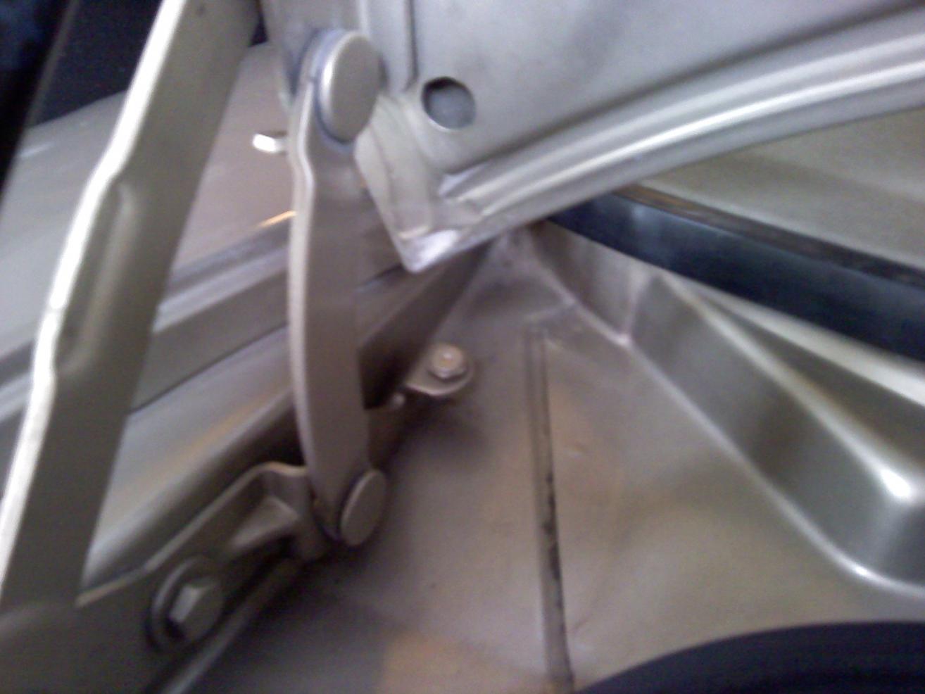

I had a similar noise that drove me absolutely crazy trying to pin it down. It was a rattle that emanated from the rear, sounding like the Gas Door was loose..........but it wasn't. Very long story short, it was solved by treating all of the trunk weatherstripping with Silicon Spray, as well as the Hinges, Trunk Catch, adjusting bolt, etc. Basically, everything that moves or contacts something else in the trunk lid area. Problem solved! Yes, there may be better long term products to use on weatherstripping, but this is what I used, and it worked perfectly. Good luck with your problem, I hope that the solution is equally simple!

I solved a similar problem by putting a small dab of grease on top of each adjusting bolt at the FRONT of the Trunk Lid. This is a metal to metal contact and needs lube.

Any pics of what your referring to guys? Hmmm, recently noticed a rattle from my trunk area also, thumping the lid by the 3rd brake light produces a noise, but sounds like its from under the car. Thought it was the mufller or exhaust...but its solid when i move it or 'thump' it. It is annoying.

I think this is what he was refering to H20 (see pics). The driver side looks like it would be metal to metal but the passenger has that rubber sleeve that holds the wire. When it closes, the curverd brackets might hit but that's not my problem. Sounds like you may have the same thing I do. When it was on the lift at Jag, I asked the tech about it and he had no idea. I thought loose heat shields, exhaust, or brake dust shields, but to no avail. Sounds like metal to metal and it comes from below the car around the rear tires, suspension. If I could be under the car while driving, I bet I'd find it right away but highly unreccomended.
