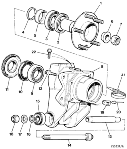

they replaced item 1, along with wheel bearings and seals in a kit QWB708
they called item 1 the hub assy.
the nut had backed off several threads causing the wobble the in tire and impinging the rotor on the carrier resulting in scoring of the rotor

I understand now - the hub and bearings, not the hub carrier.
After correct shimming on the bearings, the hub nut is finally tightened to a massive 304Nm so it's amazing it has backed off.
