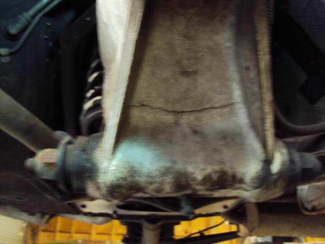

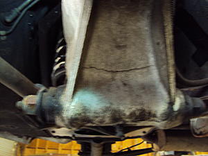

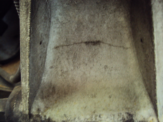

Inspection of my new 90 XJS Convert revealed this...cracked hubs. I saw the bent strut and thought it may have been the cause; but the other side is cracked as well...not as much, but still it's a crack! Can they be welded in place without destroying the seals? (Probably Not I'd guess.)
I'm not comfortable with it but is it something I must rectify?

Welded probably, but sourcing a used rear end isn't too difficult, and if you find a whole unit you could have it serviced with new seals shocks brake pads etc then drop it in.
It wouldnt hurt to get a quote from a mobile welding guy, even at $100/hr it would be done in 10mins. Good enough until you find replacements.

You cannot weld that casting and it be strong enough, IMO. Second had hub carriers are everywhere and are not expensive; be safe not sorry, say I.

It's a 90 so probably has ABS, if you do replace the hubs make sure you get the correct ones. Also XJ40 hubs can be adapted to fit and are stronger with additional webbing.
You could TIG weld them and have additional X brace added. Talk to a shop that repair mag wheels they may be able to weld them. The biggest issue would be warping.

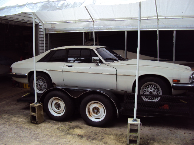

I called a Jag specialty salvage yard in Sarasota Florida about some hubs. They wanted $175 each side! But on Craigslist, I found a 90 coupe, 86K miles, in Jacksonville 2 hours away. The owner pulled the wheels off and verified the hubs were good, so I purchased the car for $700 in hopes I could use some other parts. Well I got lucky. It also has a serviceable exhaust system (from what I can tell so far); my resonators, over axle pipes and rear mufflers are shot. But the big surprise that I'm ecstatic about; in the boot was a shot fuel injector harness with broken connectors and fragile wires; and on the engine; A New Factory Harness...WAHOOOO. It has the lower front inner wheel well plastic splash guards; mine are missing, an A/C vent to replace a broken one: I've id'd numerous others bits that I need, not to mention spares for computers, HVAC, engine accesories, ABS components, etc. It also has the "Factory" side molding, metal channeling with finishers/end caps etc; mine is just a dealer add on rubber strip that does not live up to Jaguar's standard. The body has a good bonnet, 1 wing, doors...so if anyone needs some parts, send me your request. A sacrifical donor for my new beauty.

Old Jun 1, 2018 | 06:35 PM
Fla Steve's Avatar
Joined: Oct 2010
Posts: 661
Likes: 108
From: Deland Florida
It's still on the trailer and I can't open the doors but a few inches at present. It's the tan or beige interior color. The boot carpeting is not very nice, and it's missing the panel/piece that covers the gas tank...I have to assess the exhaust once I get it on the lift. I've seen lots of exhaust manifolds on Ebay and Criagslist; but they may be for earlier none catalytic cars.

is the cracking in the rear hubs frequent? I had never seen them crack like this in the flat part of the arm.
What causes this cracking?
Would not recommend welding since you are dealing with a suspension component that has no back up, ie, it breaks and the wheel assembly will beat the crap out of the rear quarter panel and the fender well.
This will be a disaster on a unibody vehicle.
