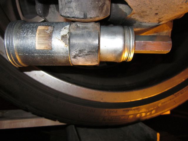

I built a press out of 1 1/2" ridge conduit coupler (resever) and fence top rail coupler (pusher). I'm using a threaded rod coupler as the compression nut, it's 1 1/2" long so you get lots of threads. I'm using my 1/2" impact wrench to drive things home, but as you can see things are not moving. Right now it's starting to mushroom the pusher. I will start with propane heat and hope not to have to move to acetylene. I don't have a problem with working room because the car has lowering springs on it. This gives me enough room to work on the bushing w/o a spring compressor.
Any addition help information would be appreciated!

Are you definitely on the bush and not the carrier?
I'd think with that setuo it should come out OK.

I know my pusher is small OD than the outer sleeve of the bushing by a few thousands. Anyone try pushing on the inner sleeve of the bushing?

Couple of things I would try. First, use a couple of sockets from your least favorite set with a nut,bolt, and washers. They can withstand the force. Then if you get the bush started and the socket within the bore of the shock, you can continue to screw the bolt or hit it with a BFH and it should come. Another thought is to saw through the metal bush so it collapses easier, and press or pound it out.
You will just push the centre out leaving the outer sleeve in the shock

Yes, and DO NOT pull the new one in by the centre bush, you will wreck it.

My next trick is to use a socket if I can find the right size. the mild steel pusher is just deforming. As far as pushing out the center, has anyone done this? That would make cutting through the outer sleeve a lot easier if I go that route.

I haven't tried it, but it makes sense. You're not trying to save it, so if it comes out in pieces it's okay.

I have pressed out the center and then cut a notch in the outer sleeve to change all of the bushings in my car. It is far easier and faster than pressing out the old bushing intact. Cut the notch facing towards the shock tube in case you cut a hair too deep. As Steve mentioned make sure you install the new one by pressing on the outer sleeve only

I got one side out last night after pushing out the center and then cutting it on two side (not all the way through because I was careful not to cut the shock eyelet), I then used the 1 1/8" socket to push the outer portion out. It went fighting all the way. I didn't get to install the new one because I had deformed the pushing nut (long rod coupling nut) while hammering it earlier in the process. I had to go buy a new one and then by then it was too late, still need to eat dinner.

I'm going to try removing the other side with the 1 1/8" socket first before pushing out the center, but must admit 20 tons sound nice.
I also got out my wheel cylinder hone, that I hadn't used in years, to clean up the bore of the shock eyelet. I hoping it doesn't require the same amount of force to install the new one as it did to remove the old one. I'm going to start with the old sleeve as the pusher first, if that doesn't work I'll have to remove the grease boot and retainer springs clips to use the socket as a pusher, maybe a trip to the freeze for the bushing would help.
