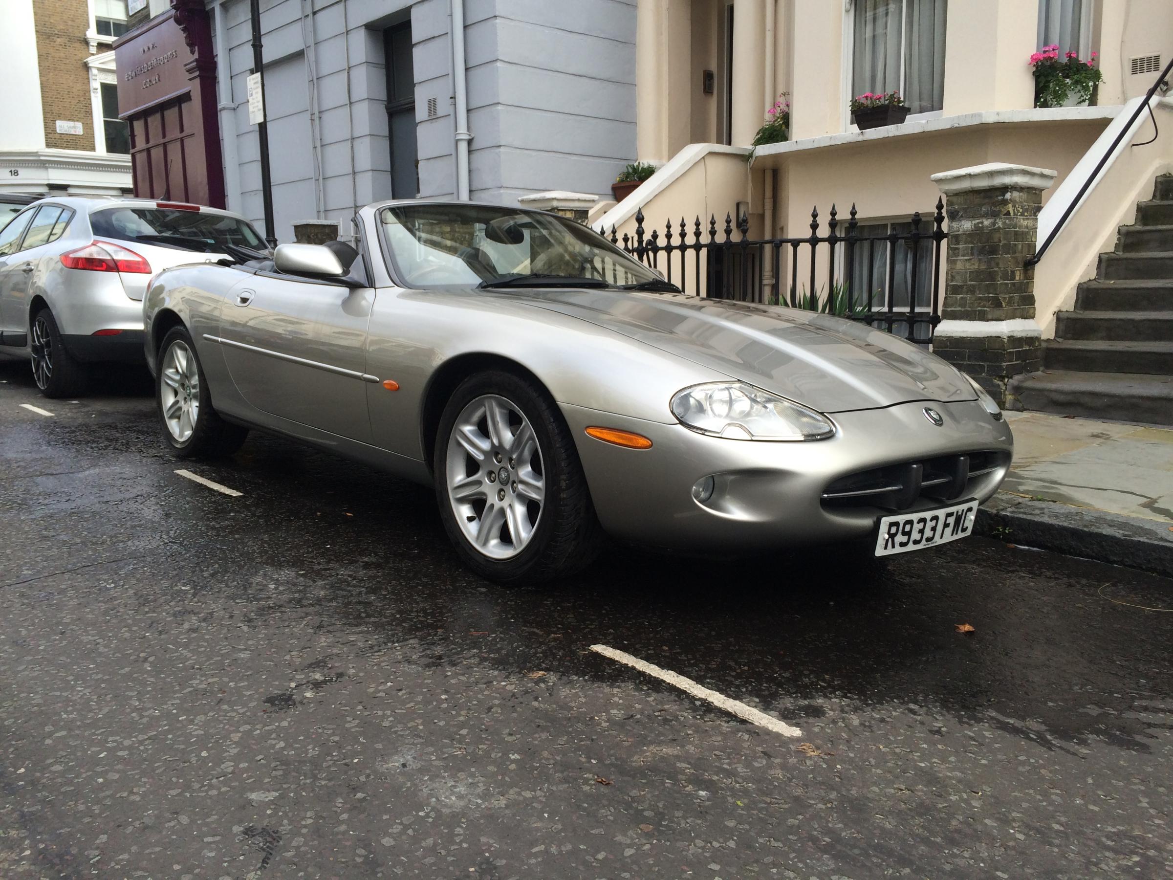

I have today managed to secure a stunning 98 XK8 Convertible. I love it.
Everything has been done inc timing chains and it's running just perfect
Anyway - the rear speaker on the passenger side seems to be knackered, it works but its farting away with the bass - i have everything set to 0 - so it's not the settings - do you access them by just pulling the cover off or what - how do you get at it? cheers.
