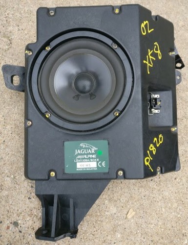

I have no pictures of mine, and going into the rear always leaves me repairing brittle plastic, so mine looks like below. Have no pics of reverse, and do not know if they are 2 ohm. Seemed to remember they are either 2 or 4.
Random picture snagged from the internet of LJD4150BA (other side is 4151).

Same speakers I have just mine are out of the box.
