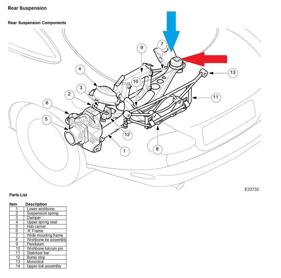

YES - that's the A Frame as michaelh has already identified for you. One of those large bushes (arrowed in red) on either side.
The bushes are a regular failure but more recently there's reports of the entire A Frame rotting. The support brackets (arrowed in blue) are also known to rot.
A careful search for solid replacements is essential.
