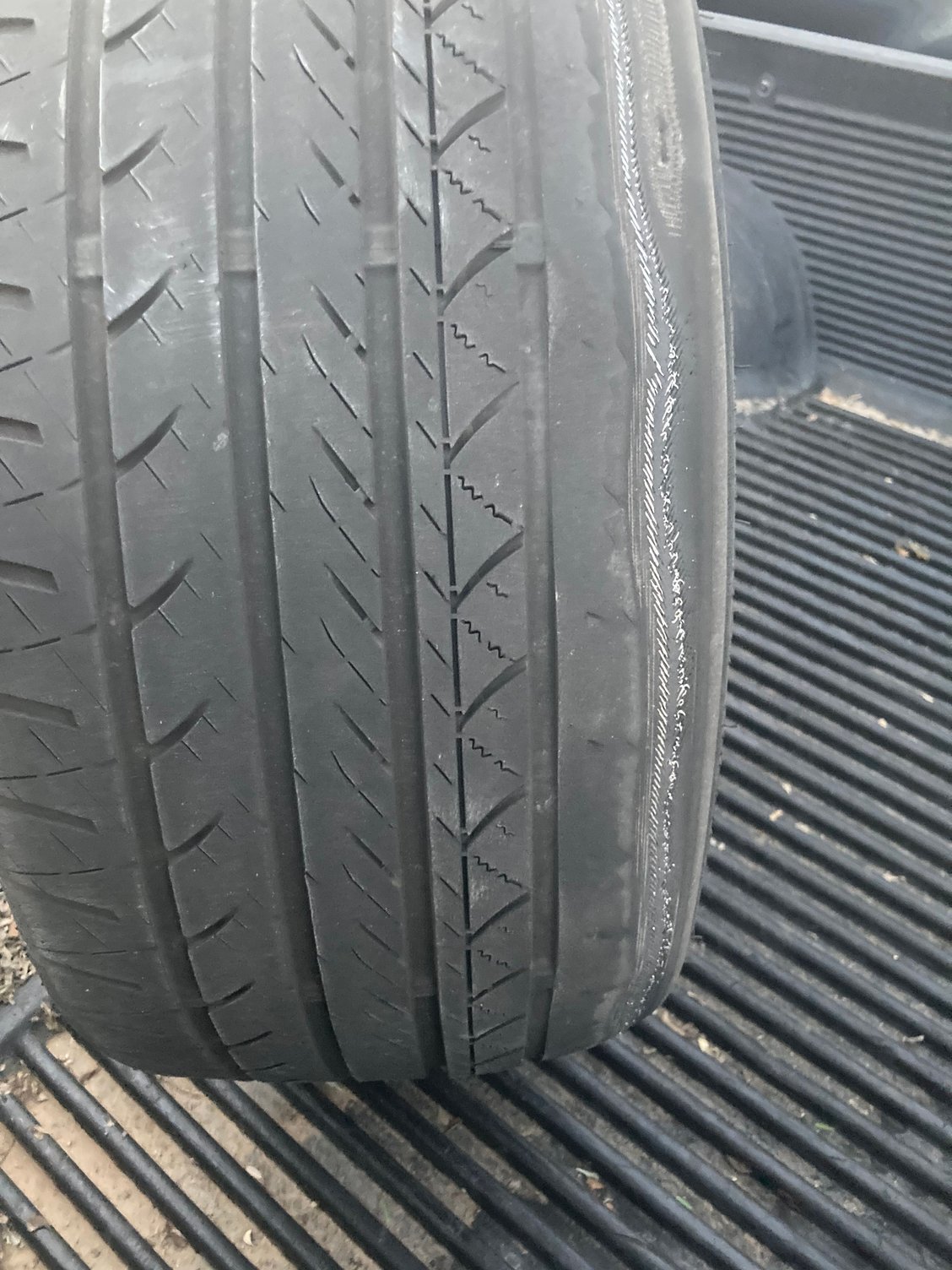

My tire was flat today, took it off and found this on the passenger side front tire, inside tire worn to metal. Proceed to check the other tire and same results. Is it time to renew my suspension? Car has 161k miles on it currently, previous owner maintained the car really well but I am unsure of the condition of the suspension. From visually inspecting it myself I don’t see any bushing or anything that is overly worn. Current tires only have 5k-10k miles on them. or do I just need and alignment? The bushings look good if you ask me, minus the top shock mount bushings
Inside tires worn to metal

Your alignment is probably out. Mine did the same and the alignment was well out of spec.

If your suspension has not been rebuilt in 161,000 miles, it is long past due for shocks, upper shock mounts, control arm bushings, etc. Many threads here on the forum to guide you through the process and explain where to obtain the best components for your rebuild. Wayne (cjd777) is making the best upper shock mounts available for these cars right now. Several forum members have recently installed them and are extremely happy with the results....

Appears most like cause is excessive negative camber. Probably due to Defective (BAD) Upper Shock Mounts, possibly weak front coil spring and suspension bushings. Could be Excessive Toe Out but Tread edges not feathered. Probably need Quality New Upper Mounts, possibly new pair coil springs and bushings replaced in upper and lower control arms, possibility Ball Joints. Yes. maybe a complete F/E OH.

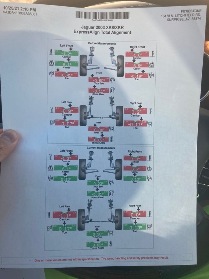

Replaced my shocks mounts using the technique in the above YouTube video. Had to pry the lower wishbone to get enough clearance to remove the strut (like shown in the video). I replaced them with Wayne's shock mounts. I got a lifetime alignment at a local Firestone and here are the results. They said they needed special shims that they couldn't source to adjust the camber, so some things are out of spec. What are you guys thoughts on this alignment? Pretty normal? Or do I have to do an overhaul of my suspension.

Steve, That camber is very close.
I'll let the experts come in and give your numbers a going over, but isn't the camber within .1 degrees of being OK?
The caster may be the problem on the right and the shim pack could be changed to help that or your bushings in the upper A arm could need replacement. If you did that, then the shims may be the issue.

Examining your alignment sheet,. The caster is function of the spacers and bushings in the upper control arm. There are specific locations on the L & R sides for the varying thickness of the spacers. Perhaps the UCA bushings could need replacement due to age or high mileage. Some of the readings approach the Min-Max limits, but are w/i the Factory specs. The Toe In appears w/i Factory Specs as does the Camber. The Camber Specs listed in manual is -1.8 Degree to +.18 degree per side. Your Camber shows -1.3 degree per side. The Toe In (.13') is also w/i the .08 to .13 per side. The Caster Factory Spec per side is 5.87 to 7.27 degree per side. Your Caster appears w/i these limits. This info and specs are from the JTIS P. # 54.
As suggested by Forum Member, Motorcarman, the shop should apply slight force to spread the front wheel outward at leading edge prior to making measurements and adjustments. This force is needed to simulate the wheel-tire orientation as it is actually driven. My XK8 is not too far from your mileage at 157,300 plus I had new Suplex Front Springs at 150K. The Poly Mounts we installed from Wayne are doing great and expect them to last. Energy Suspension Poly is First Class.
