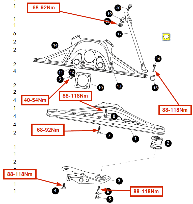

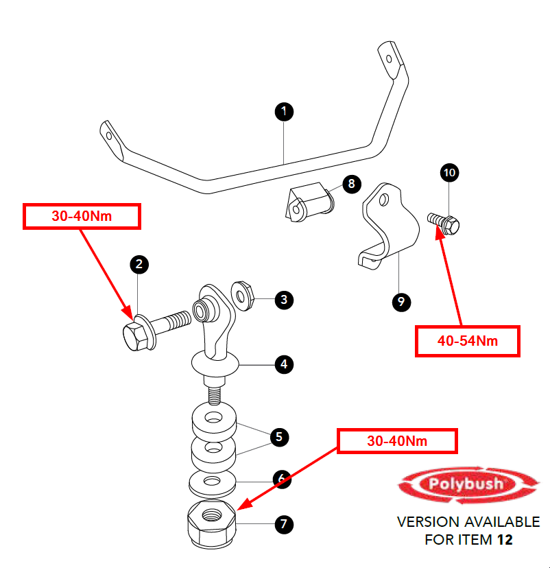

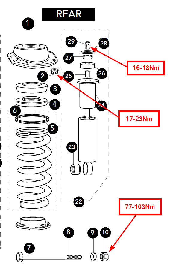

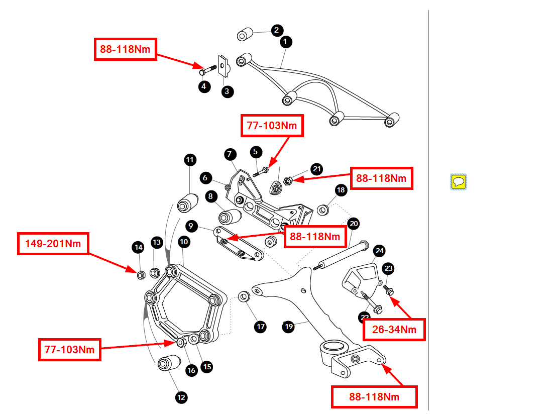

I'm starting to see the tail end of my rear subframe work and am at the point where I need to start torquing. I took the torque values from the table in the JTIS and marked them up in the exploded views in the SNG Barratt catalogue, but the JTIS parts description aren't entirely obvious to me so I'm only 95% sure I have it correct. Posting here to see if anybody is willing to do a bit of quality control on it?
DISCLAIMER: At the time of this posting, the values in the figures should be considered unconfirmed.
