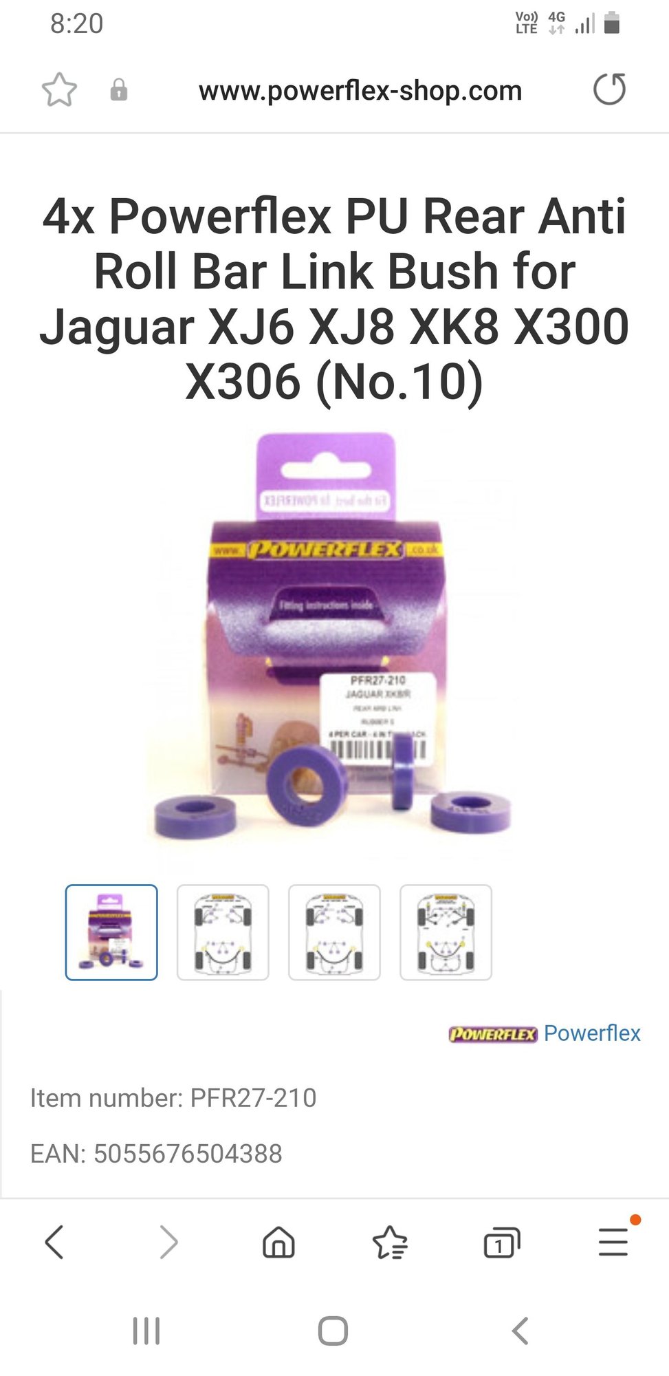

Originally Posted by dfbender
can you give us the Powerflex PN?
Here you go.
