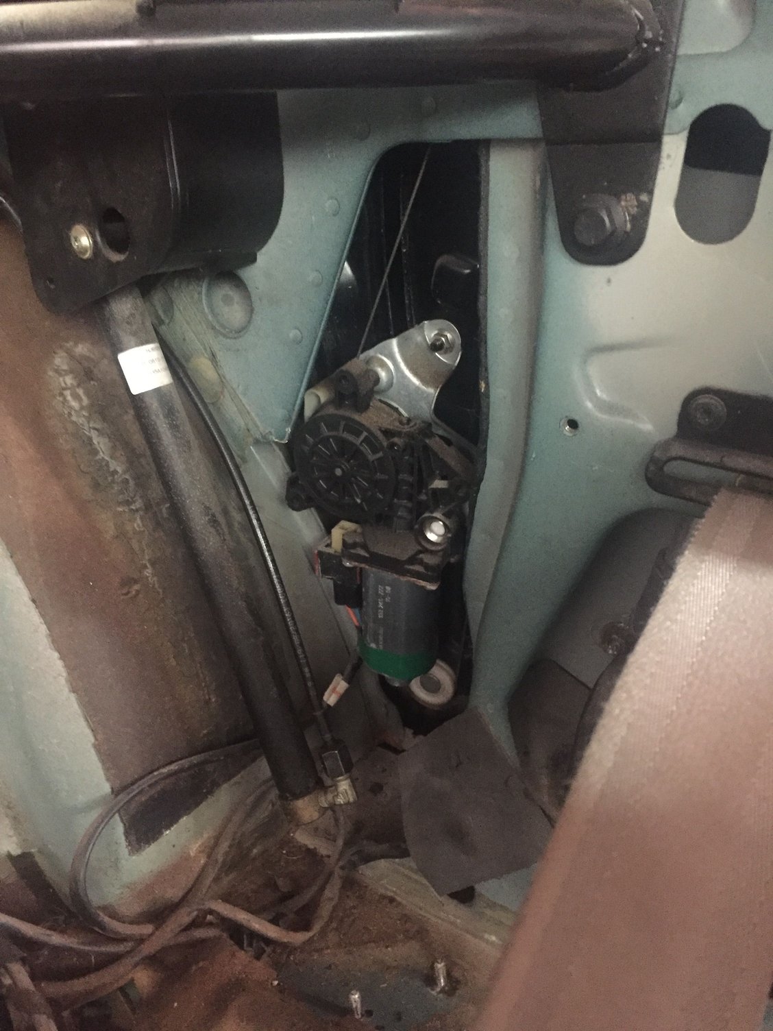

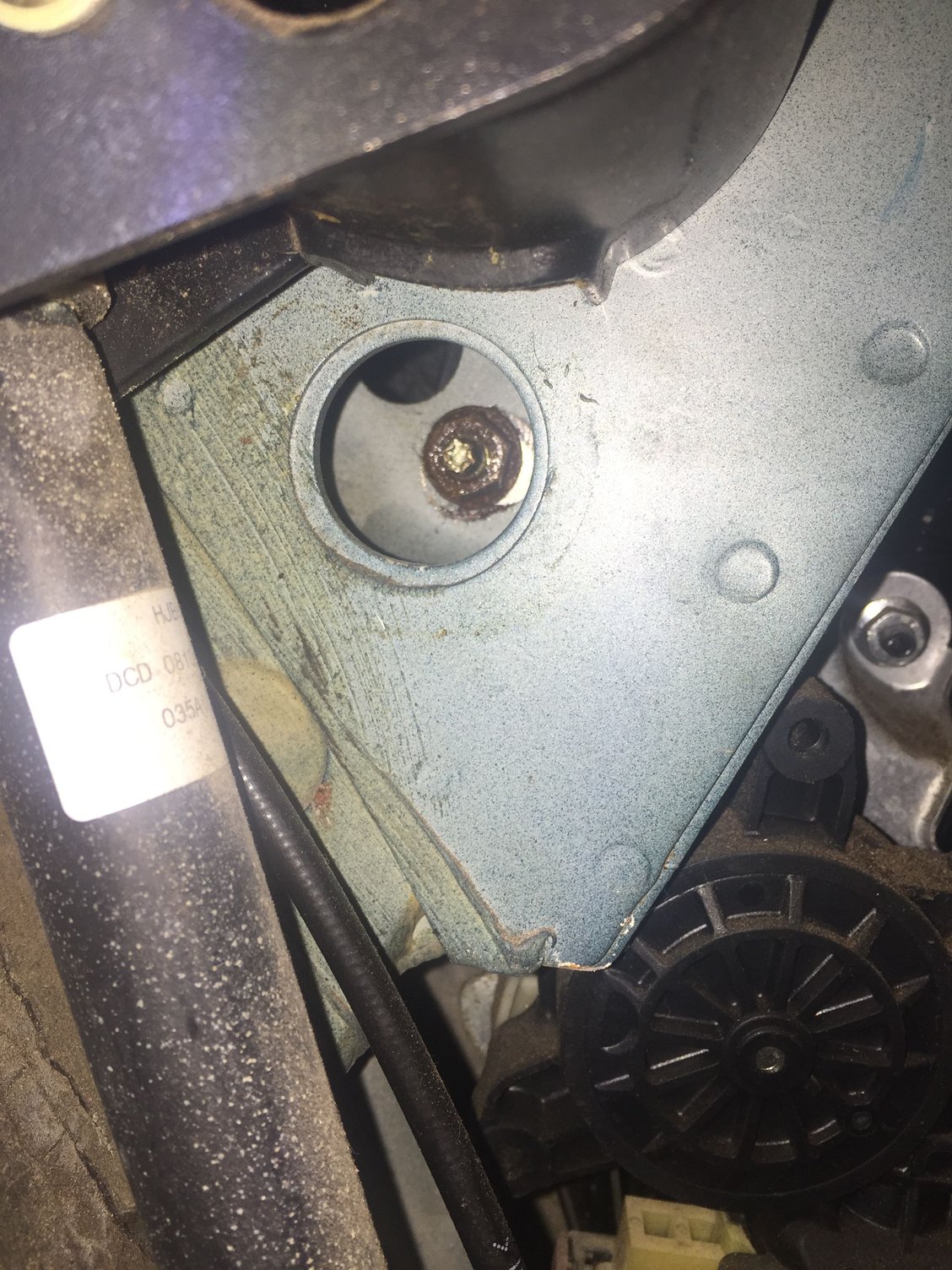

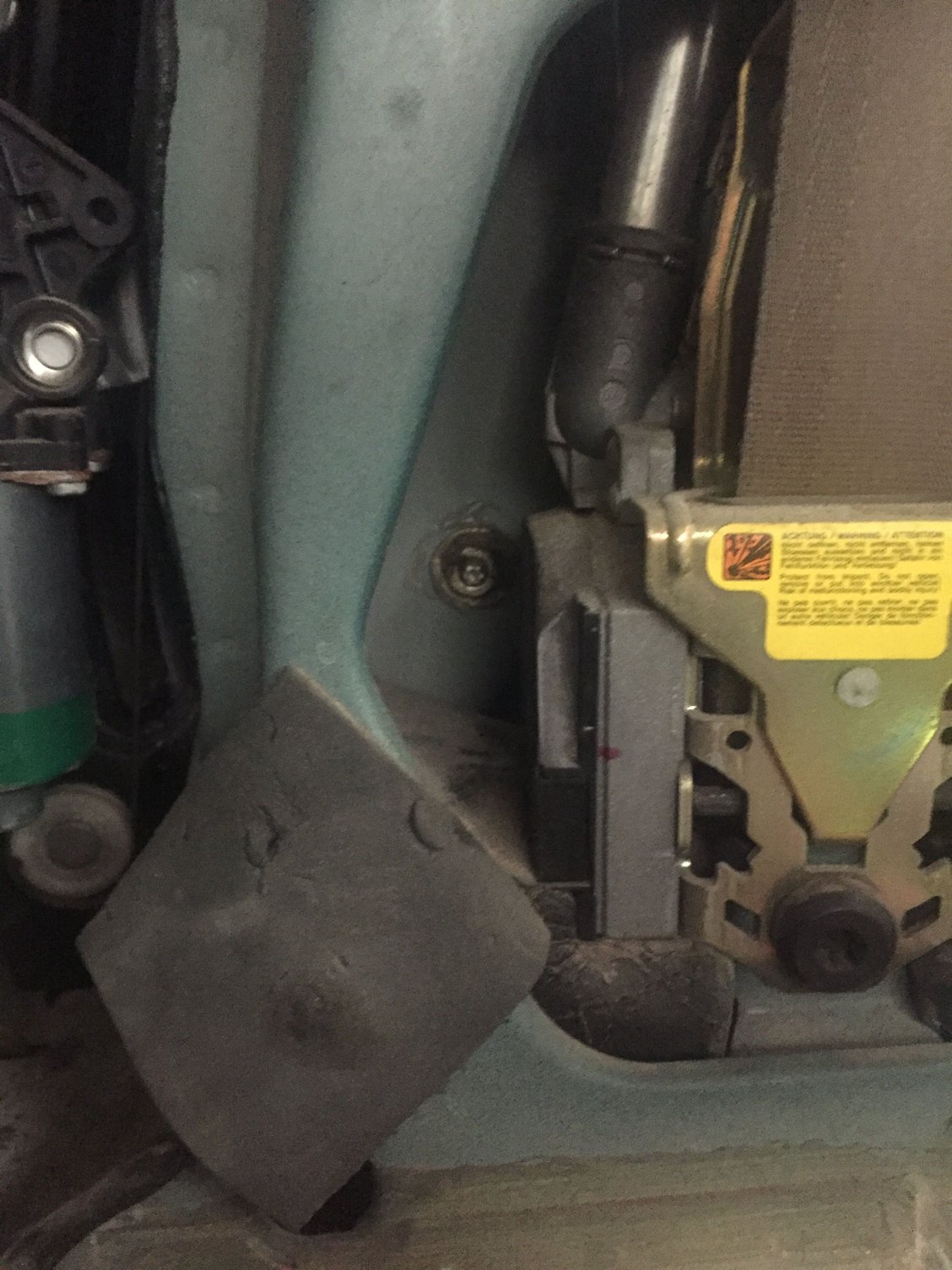

Three adjustment bolts on the window regulator
Steve,
From what you say, the rear window, in the car, can be moved by hand. So it points to the 3 adjustment fixing bolts on the regulator. These are probably loose and you may want to check on the threads as these could be stripped out.
The 3 bolts are in a triangular arrangement around the perimeter of the regulator. See pics below. The bolt at the bottom was my problem when I had the same loose window. You can see the marks where things had moved. I put some locktight on the threads when I bolted it back in.
