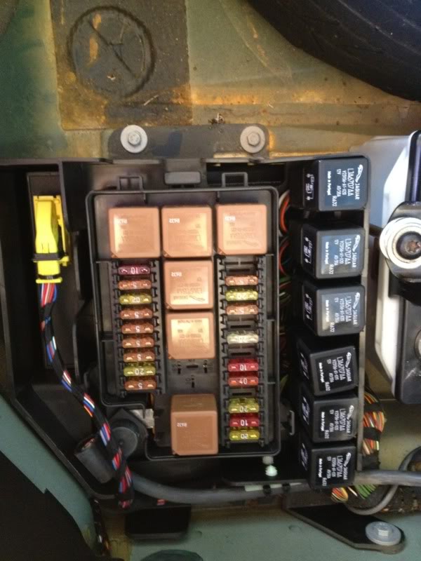

Trying to work this out but my fusebox looks a little different in my 97
This is the same as my fusebox and I know this thread is quite old but I would appreciate any help on this subject before I start t strip the car to access the failed regulator.
Attachment 164131
What am I missing here? Trying to get this fixed on my day off...
Thanks.

See page 24 on this link it will show you the relay assignment.
Link. http://www.jagrepair.com/images/Auto.../jagxk1997.pdf

Hi, Whitexkr! i m new on this forum , i bought a xk8 convertible a few months ago , and problems appear one after the other. the most recent concerns the roof. A big leak appeared on the hook. While waiting to disassemble, I switched to manual mode (by opening the pump valve and with the key), but the rear windows remained down. thanks to your explanation and the photo, I was able to bring them up. So big big thanks!

@WhiteXKR I've seen a couple videos on how to raise the rear windows (they are down and my car has the green shower), however im still confused on what to use for the jumper wire...and someone said they used a paperclip? Could someone explain exactly where to stick both ends and what wire or object to use...thanks!
