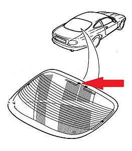

Hi, My fairly new Jaguar remote LJA2610CA bought from Jaguar U.K. was programmed successfully and worked for a month or so, but now does not work unless I am in the car.
The batteries have been replaced and the remote has been checked and the prime suspect is now the receiver in the car. ( whereabouts is the receiver any way?)
If the OBD2 was called up would it show a receiver fault?
Any thoughts appreciated. Cottonwood.
Old Mar 5, 2018 | 02:57 AM
Likes: 17,005
Check the aerial connection at the top of the heated rear screen:
It's a push on connector.
