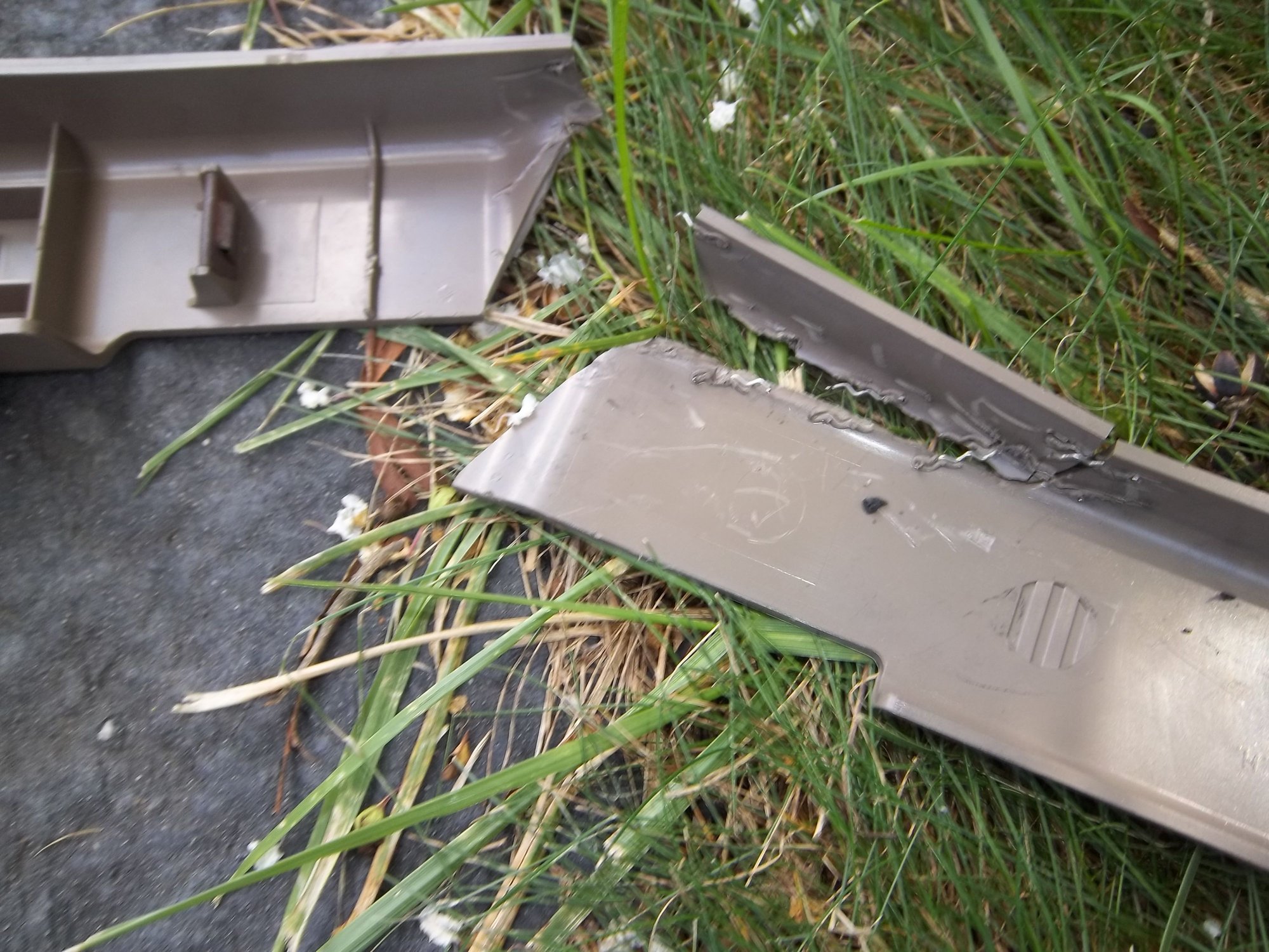

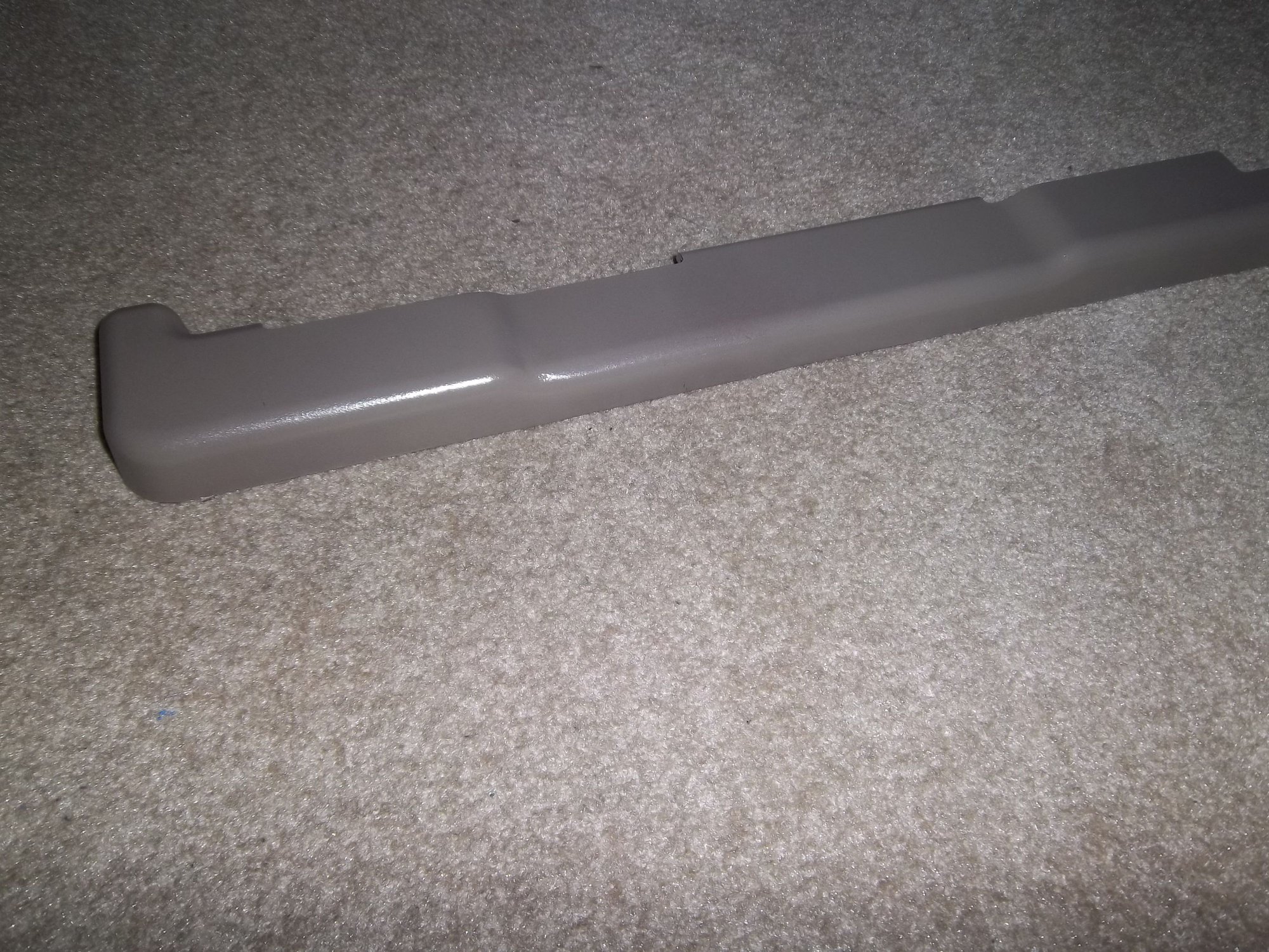

Having had the same problem, 10 years after the last post, I ended up breaking the trim piece. I saw no other way to do it. The sticky tape was welded on there. I broke off the front piece to get to the bolt that holds the seat in. The other 3 bolts have easy access by moving the sat back and forth to gain access. Once I broke the trim piece off and took the last bolt out, I pivoted the seat up, as I needed to access the parking brake. Once the seat was free, I was able to get much better access to the trim piece and was able to pry it off, with a lot of effort.
If you can get the trim piece off without breaking it, more power to you, but I could not. Anyway, I got the remaining pieces (Photo 1) and used JB Weld, which is an epoxy, to secure the pieces back together (Photo 2-3). I did multiple applications on the front and back to ensure full coverage and strength. I then hand-sanded the epoxy smooth, but not too smooth to give it some texture, as original. Once sanded properly, I used some primer, then I painted the piece brown (sparingly and lightly), then I shot it with khaki to lighten it to the factory color. It's not perfect, but it's extremely close. As you can see on Photo 4), it turned out pretty well. I then used some non-military strength double sided sticky tape to put the piece back on to allow for easy removal if it needs to come off again in the future.
The point of this is that these pieces are fairly easy to repair if you (have to) break them.

Nice job!
