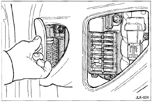

It might have been due to a bad jump start. Can anyone tell me where is the passenger foot well fuse box located?
I think that is the only fuse box I haven't checked.

There isn't one.
The Fuse Boxes in the passenger compartment are at the fascia ends.

Thanks for the reply, but dead means dead, deceased, no display, no lights, no prompts. I have checked all of the fuses with a continuity tester and meter and have continuity and power at the fuses.
