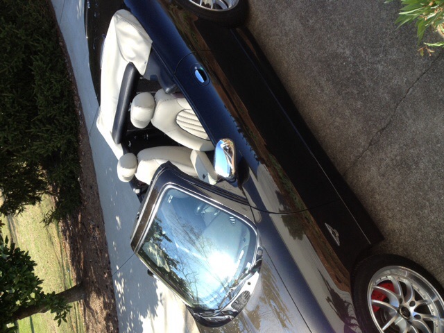

We added a thin layer of new foam to the seat before installing new covers, also added black piping to tie in the original black interior.
Mine came from tops on line and he did the stitching in black also but wouldn't do the piping in black. Made no sense to me. He was making them anyway, why not just use the black instead of the white piping! Even offered to pay more. Also wanted the center inserts in black and a no!!
Overall I love the finished look. I even used fabric spray paint and painted my headliner black. Was a pain but totally transformed the interior.
