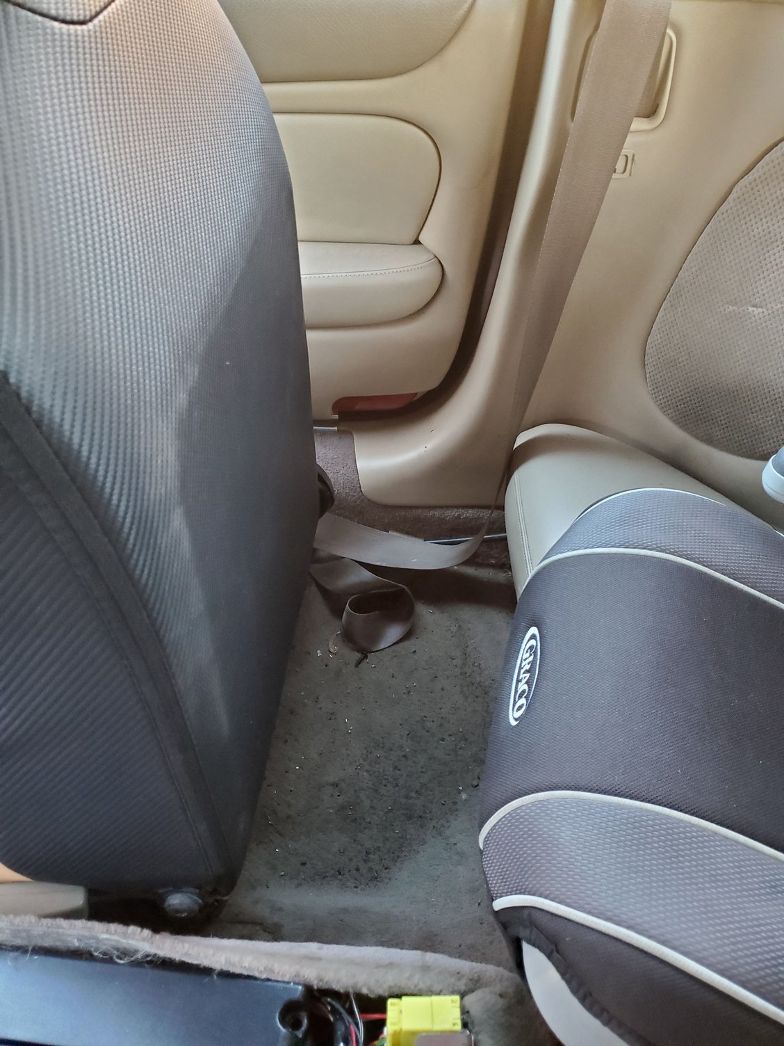

I appreciate that but I want to keep my backseat for transporting my son and his friend even after he grows out of the carseat. I want both front seats to go because:
1) They take up crazy amounts of space.
2) Their weight impacts the cars performance.
3) I have a 1st generation, 1998 XK8, so don't believe that there's any airbags in the seatbacks that I'm losing unless I've misunderstood?

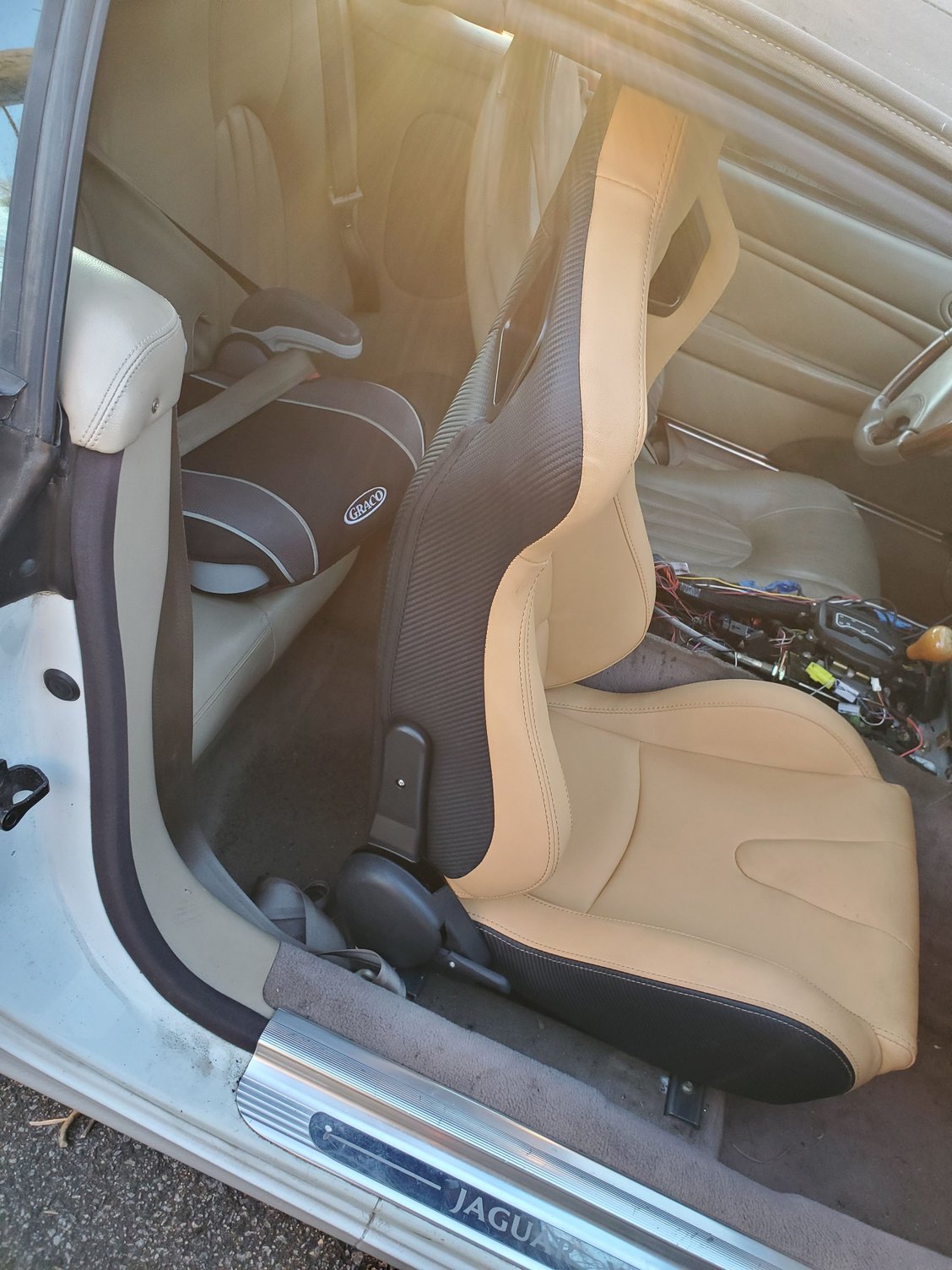

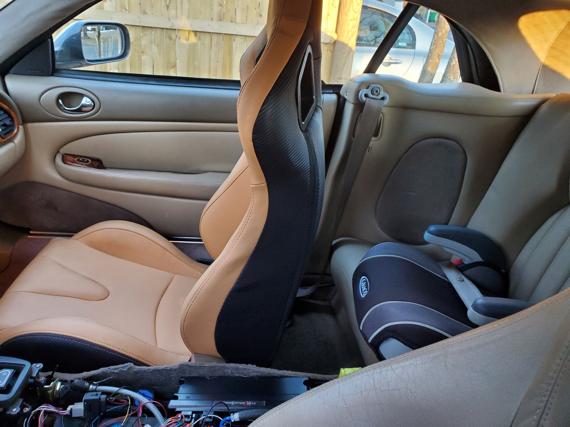

Passenger seat now installed and the difference is amazingly better. My son now has leg room because the racing seat is built differently with more space for legs. I highly prefer the reliable mechanical controls on the racing seat because one of the electrical controls on the OEM removed passenger seat was broken. The new seat is slightly less comfortable than the OEM seats but the OEM gave me electrical problems.
The installation took 4 hours to remove the old seat and install one seat as i had to drill new holes. It fits on the same rails the OEM seats used if you drill new holes. It sits slightly higher than OEM seats.
These were $370 + tax for the pair of racing seats from Amazon:
