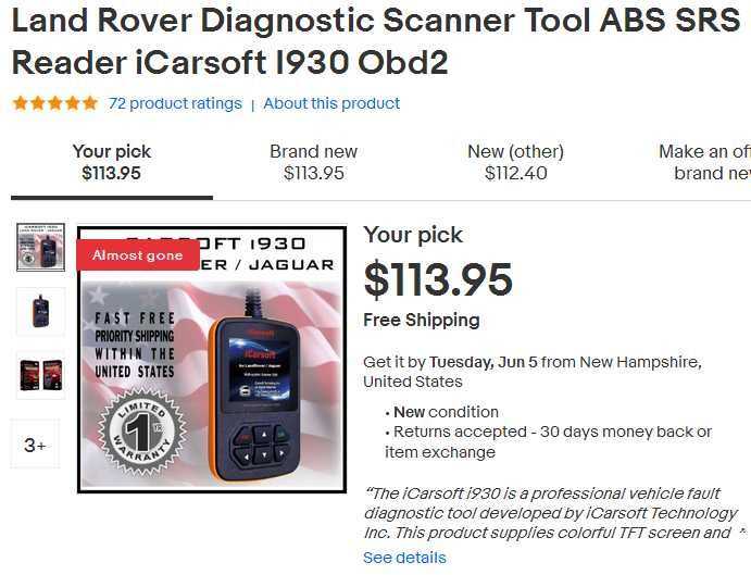

Hello Jon89.
Thank you.
I quickly searched for your OBDII scanner, and found a model 930 available from many sources from $113 to $350.
My question is what model do you have?
Very respectfully, Bob G in Ruskin FL

As I stated previously, I have the i930 that was available through amazon.com in February 2016. I paid about $125 for it. From your post, it appears that the price has dropped to about $114 now....
My i930 paid for itself the first year I owned it as I diagnosed and repaired several issues on both my wife's 2006 XK8 and my former 2005 S-Type (which I recently sold)....
