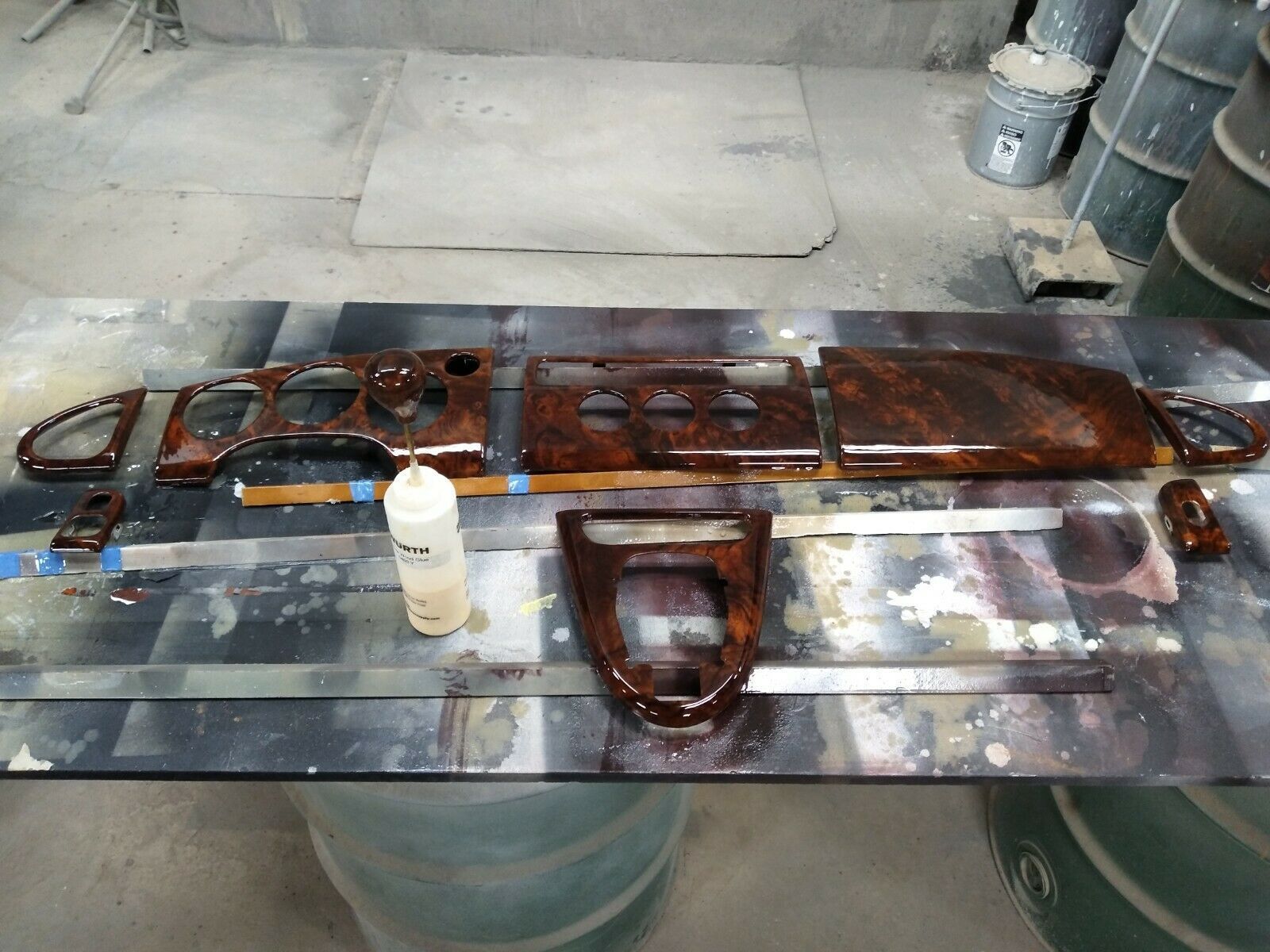

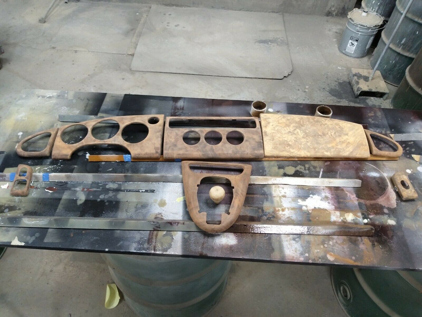

Hello,
Does anything look off in this eBay listing? It shows the restoration process, the price actually seems suspiciously low. I received a quote of $975 from British Auto Wood (though a shift knob I bought from them was fantastic, and their work looks very good, https://britishautowood.com/restoration-examples), both the price and the fact that I don't have to drive my car without wood make it much more appealing. Also, finders keepers! :P
https://www.ebay.com/itm/96-06-Jagua...d/124175047659
Thanks,
Jacob

Yeah, that's why it seems suspicious to me. I'm hoping somebody more experienced than I can get some idea from the pictures in the listing.

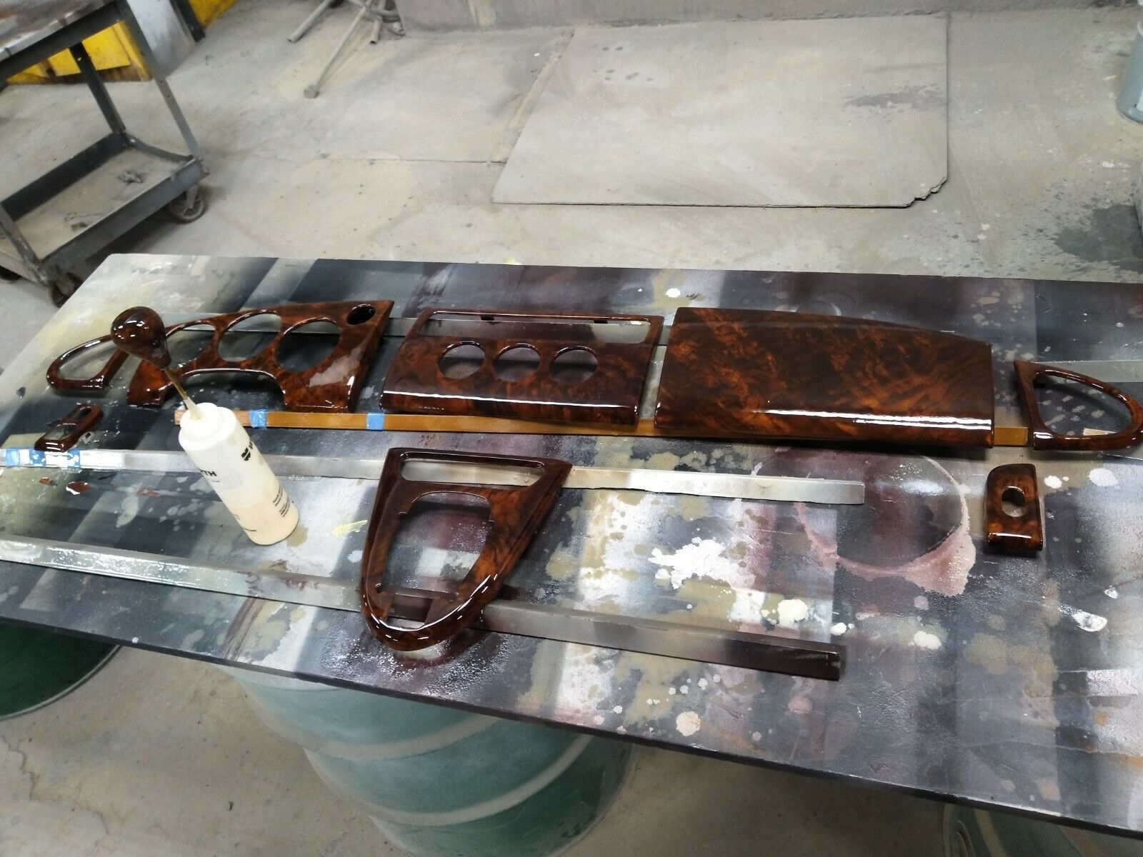

Saw that and posted about it in another thread. So, it's hard to tell the quality of the work since they took shots from far away or in extreme closups dominated by reflections. But
1. I've gotten a full wood set for about $10.
2. His/her labor in stripping was minimal since he/she appears to have some old stock methylene chloride stripper.
3. I'd have some concerns about the finish around the instrument panel wood, does not particularly look good in this view, but it's hard to tell.
It would be relatively easy to ask him/her to take some more pictures of each panel at various angles, however.

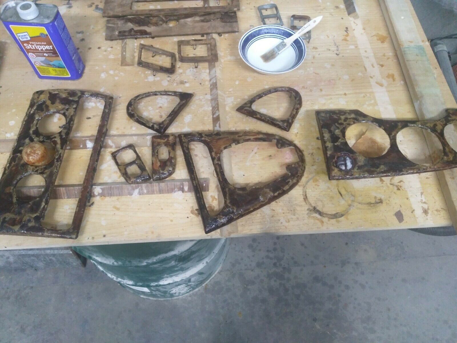

Yeah, it would be interesting to find out what kind of stripper he used.

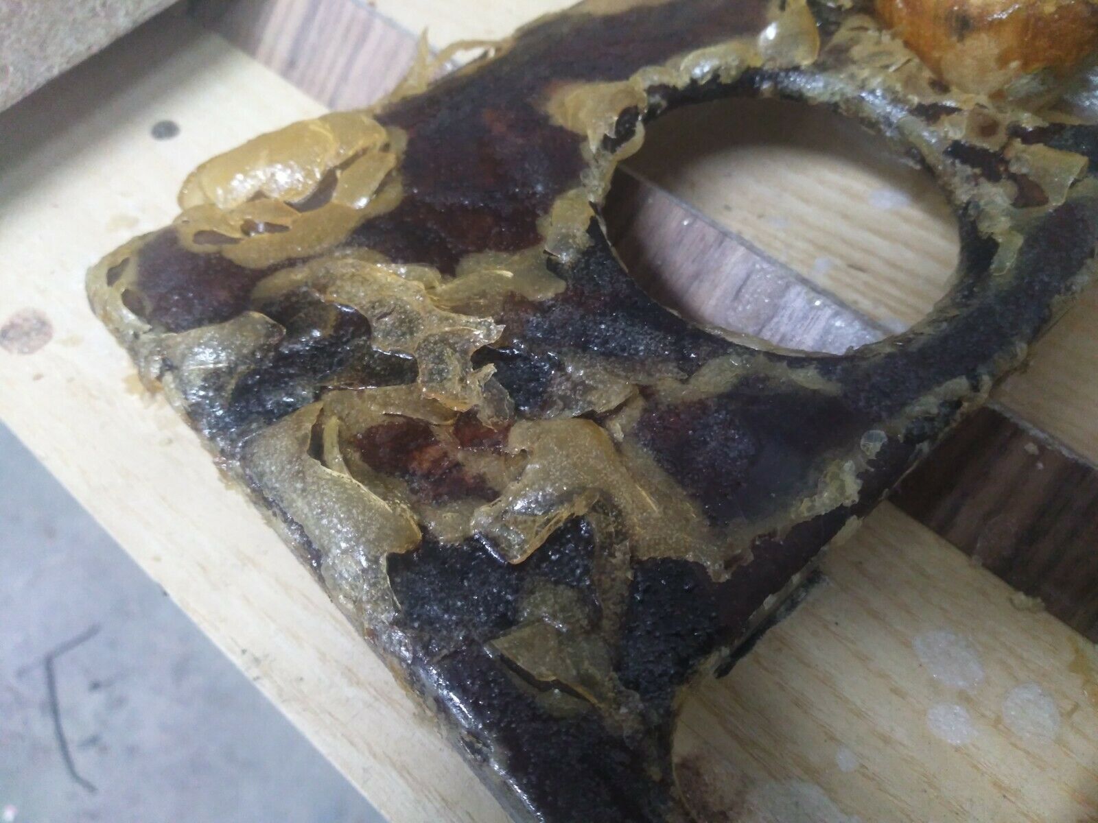

I may but I don't know if he'd take the time to reply. Stripper can be seen in one of the pictures in the listing Jimmy.
I saved all the images since eBay listings have a tendency to disappear anyway:

So he used Klean strip to remove the poly. My issue is I can never get a poly coating looking professional.

Methyene Chloride, forbidden to us since last fall, the kind you can't buy anymore unless you are a business. This is the old Kleen Strip.

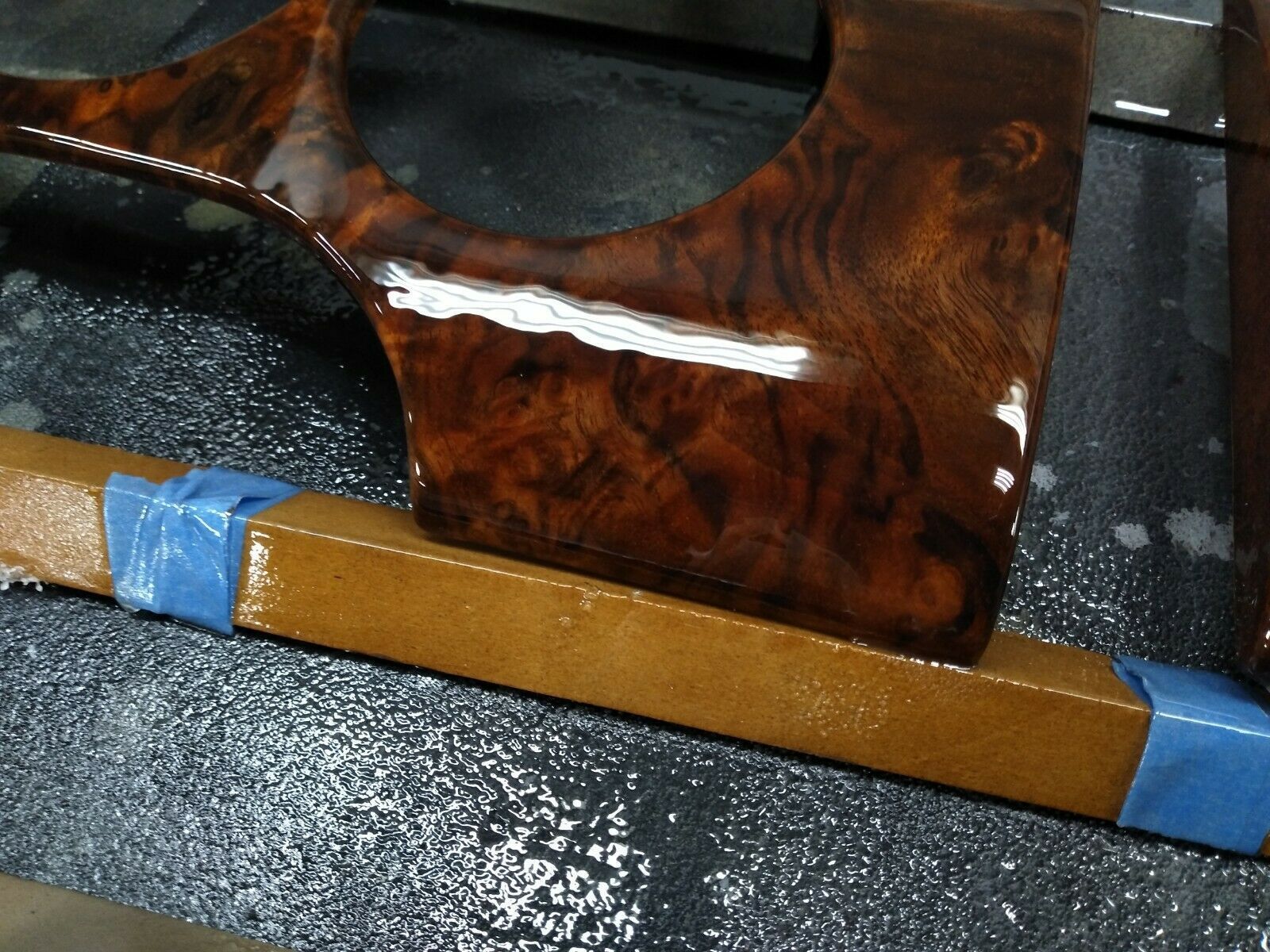

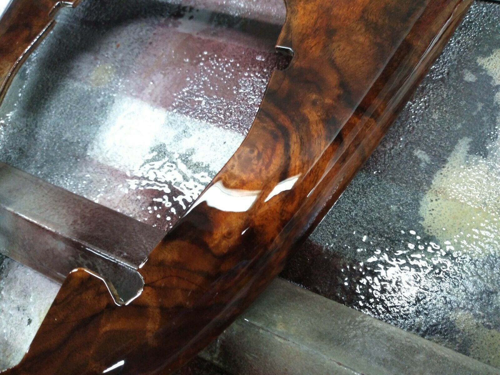

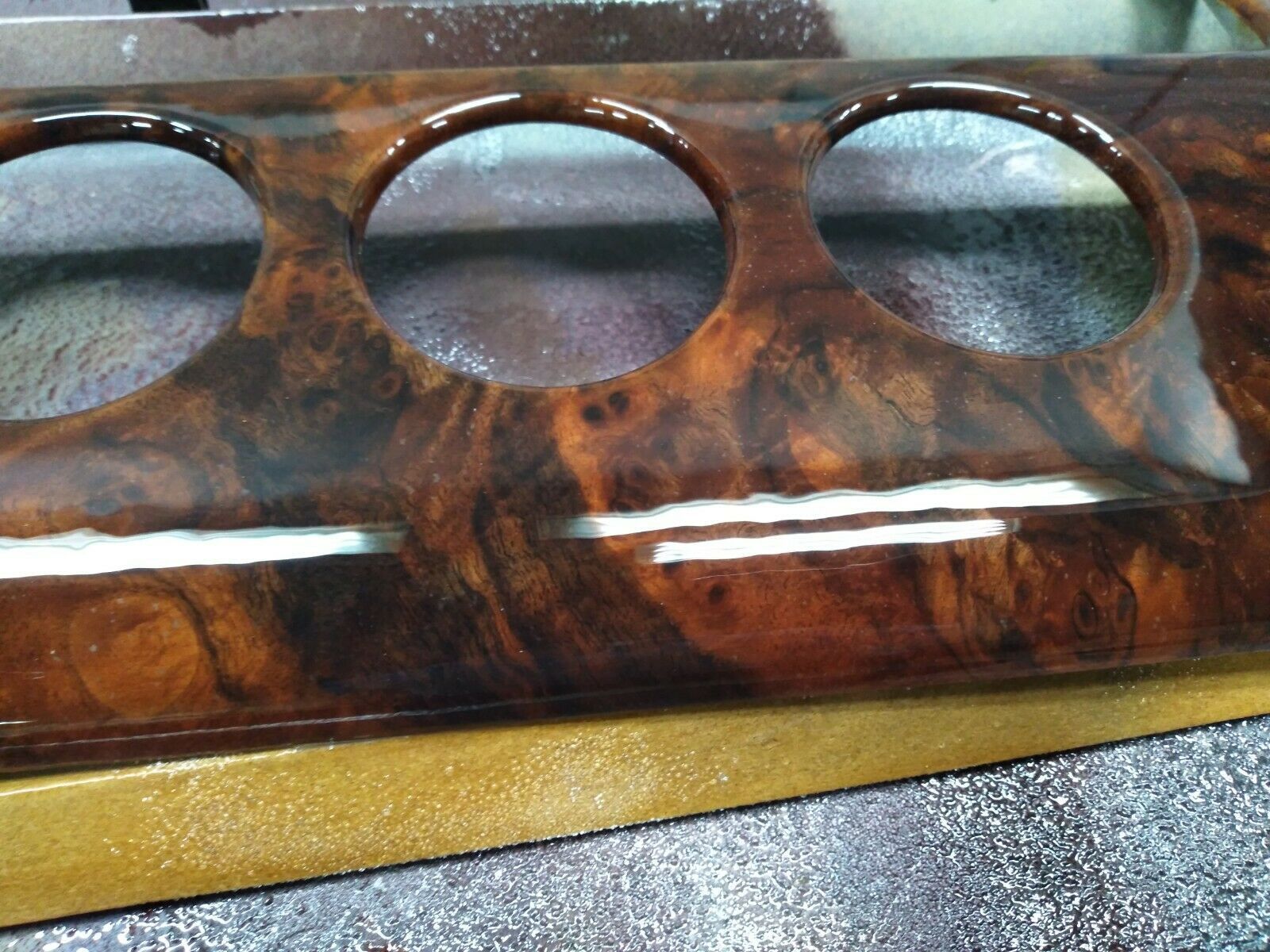

I'm suspicious of the image in the 1st photo you pasted, #8 in his ebay ad. The florescent light fixtures are wavey. That's a big red flag to me. When I finish a piece of wood, whether its lacquer or poly, it reflects like a mirror. Why would this be uneven?
Sorry if I sound too negative, didnt want you to miss this.
John
Old May 12, 2020 | 07:54 AM
Johnken's Avatar
Posts: 5,457
Likes: 1,816
From: New Jersey USA
Jacob, just did a second look. Goto that 1st photo you posted. Magnify the hell out of it, sure looks like the wood finish is scarred (its early - scar or damage not frightened :-)) to my eyes.
Could you live with it? I'm afraid it'd be a lot more noticeable than one would like.

Looks like he may have restained the wood also. I would like to know what type of final coating he used.

Sam, here are the notes from the listing:
"Completely restored. Stripped old surface. Any veneer issues fixed and new polyurethane glossy finish. 3 years warranty"
