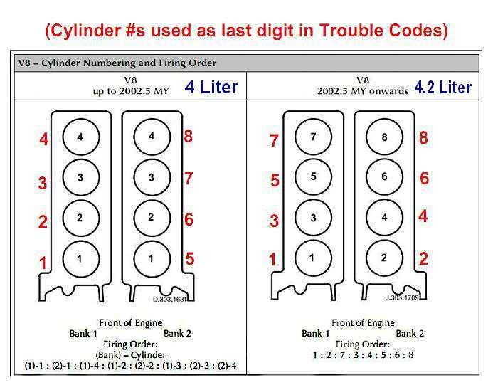

This may help:

Thanks. Misfires were in 2, 3 and 5. I'll swap 1 & 3, 5 & 7 and 2 & 4.
