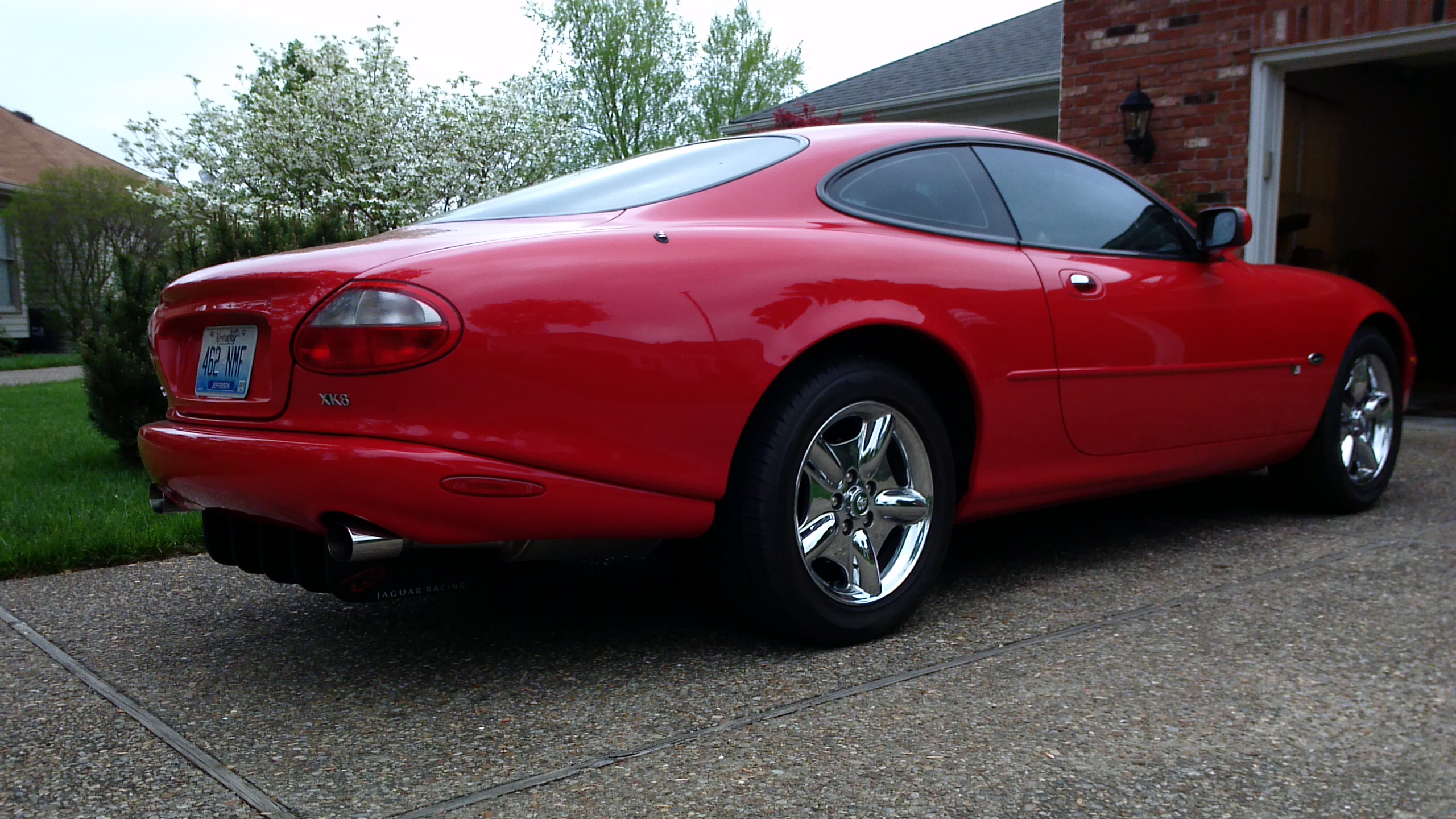

thought i would add some fun to this. self made undercarriage diffusers. also knowing the snorkel tube rots i add a thermal wrap on the bellows.
Old Apr 23, 2016 | 12:24 PM
daddyo007's Avatar
Posts: 647
Likes: 60
From: Kentucky
silver band is thermal wrap.
