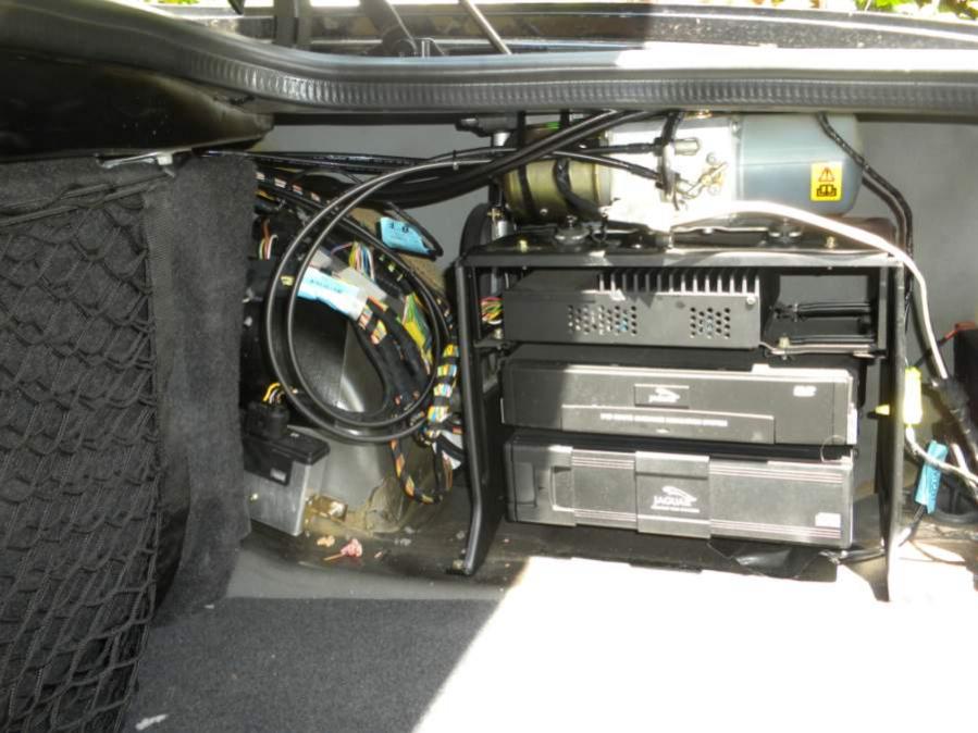

I did it. It took me 5.5 hours. I made a few erroneous steps, which cost me some time. I also ailed to remove center console. I could not find how it is attached. The wooden trim around shifter refused to move and i was afraid ot would crack if more prying force applied. Job is not completely finished because when i reached under the carpet I found out that the foam cushion was soaked. Strangely, carpet itself is dry. I tried to use a shop-vac to suck water out of it, but it is too powerful and the foam has tendency disintegrate. For now the undercarpet is on layers of paper towel and tomorrow it will be all exposed to sun (hopefully). I took pictures of this process and later I will publish them here.
First: I found that 20 ft hose is too long. I had to run it in "S" pattern ander the carpet.
I also started from the windshield from than form the pump side as other enthusiasts did before me. Most annoying part of the job was the speaker removing and cutting those dozens of wire ties.
After I finish the job, I will give a detailed description of my approach.
I am sure that someone younger and without braced wrist could do it easily in five hours.

My 1999 XKR blew a latch hose, and I've just stripped out the interior to replace them both, (not a job for the faint hearted, but I simply refused to pay the price the garage quoted..)
The hose that has failed is a Polyflex 363, and I'm waiting for the new ones to arrive from the jag dealers.
This thread has made me realise that this isn't an isolated incident, and I've contacted LSI contols to enquire about getting a low pressure conversion kit sent out to me here in the Uk..
I also have some oil soaked into the foam under the back seat swab, which appears to have come from the hood lift ram on the left hand side of the car ( RHD) there are no specific signs of where its come from, the whole ram and the area are covered in dirt and oil, so I assume its oil mist from the ram top seal.. I was going to replace the ram, but I may just see how it goes once the low pressure kit is installed..
