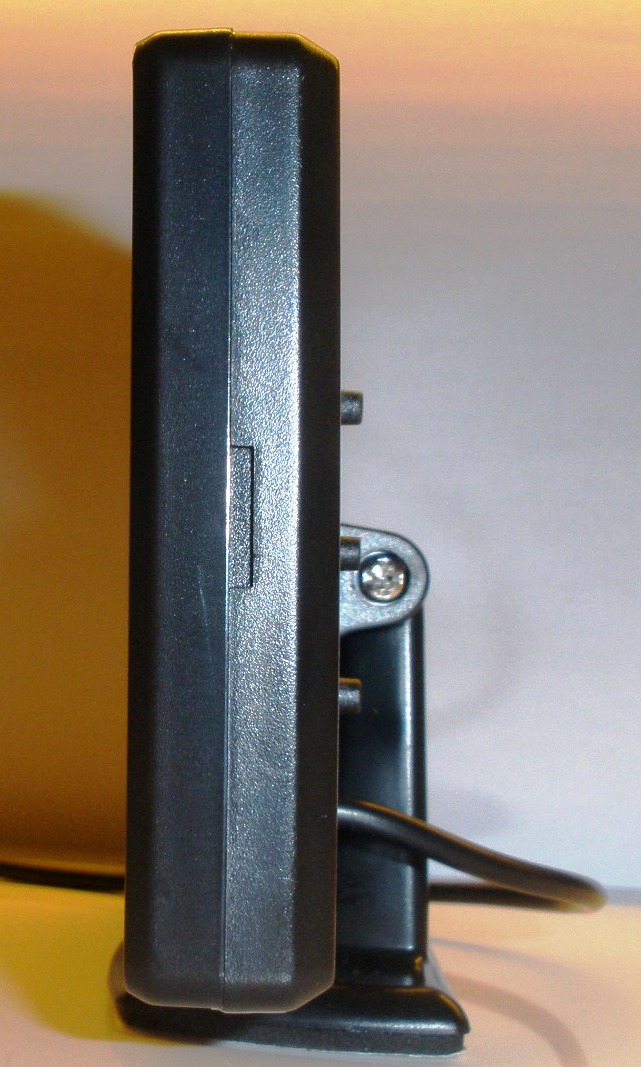

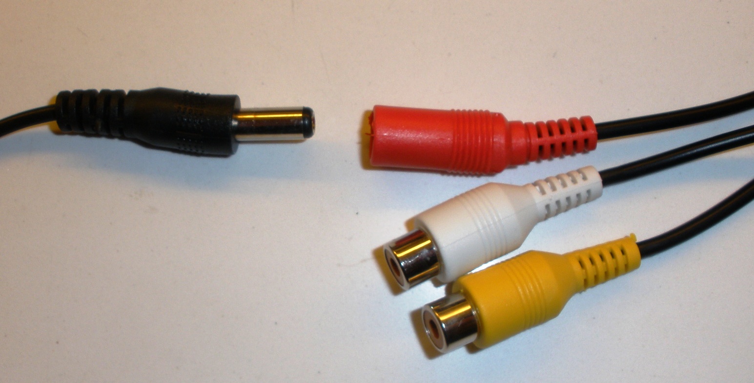

Here is my solution for a reversing camera with screen.

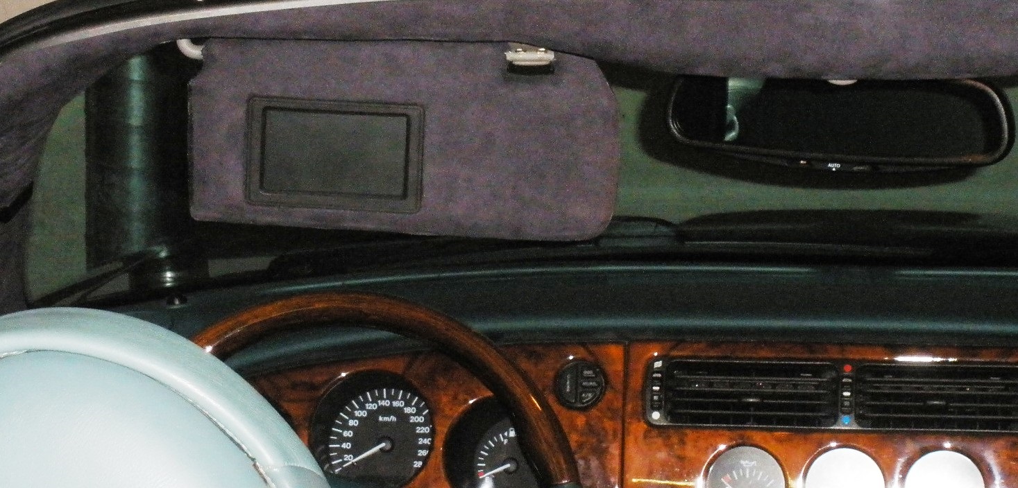

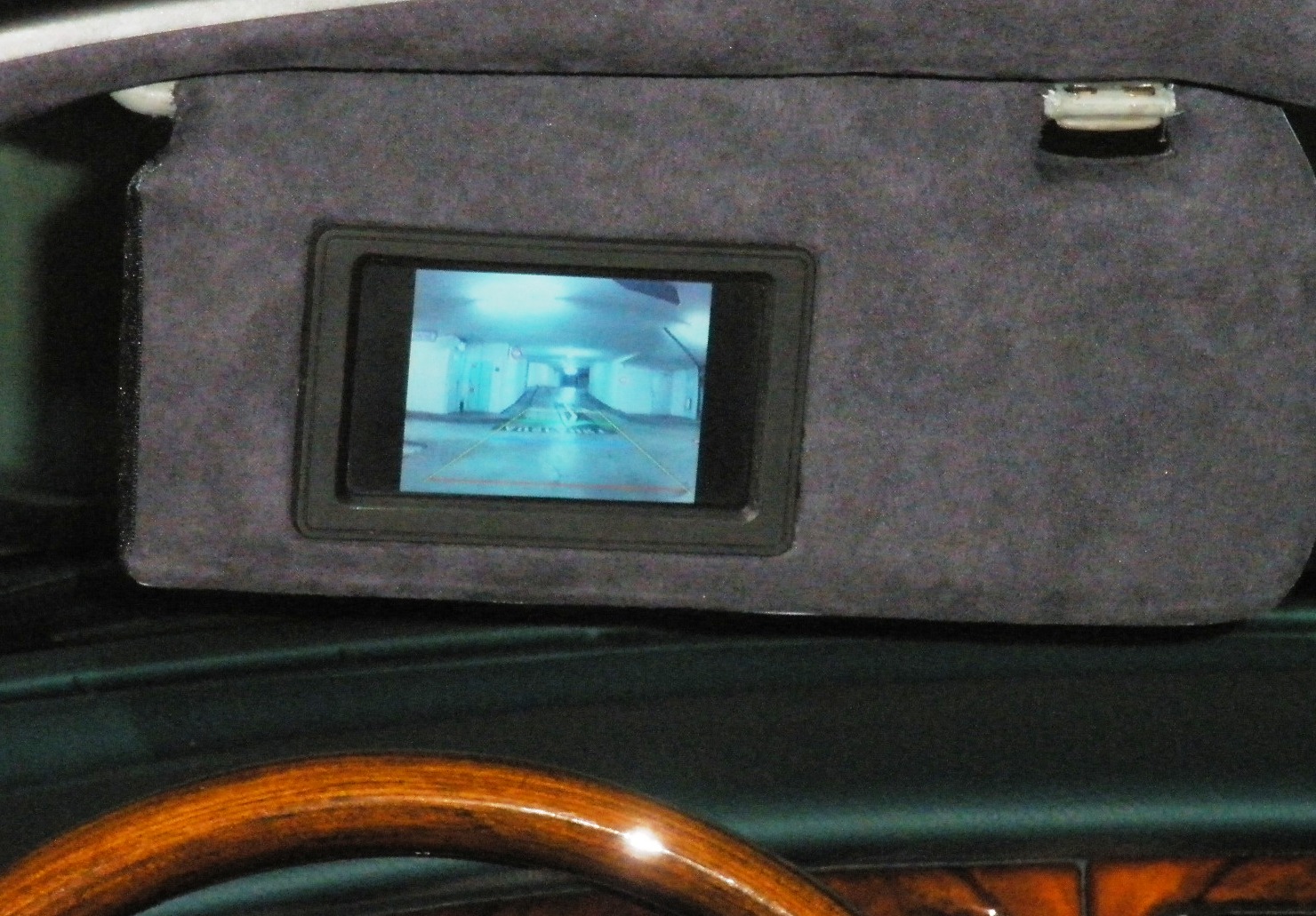

Since I do not need the make-up mirror, unlike to my wife, I decided to install the screen in the sun visor. I also did not want to change the fittings and small instruments, in the middle. The A-pillars and the roof lining I covered with Alcantara. So I could revise the sun visor.
I have a 4.3 inch TFT LCD screen installed.

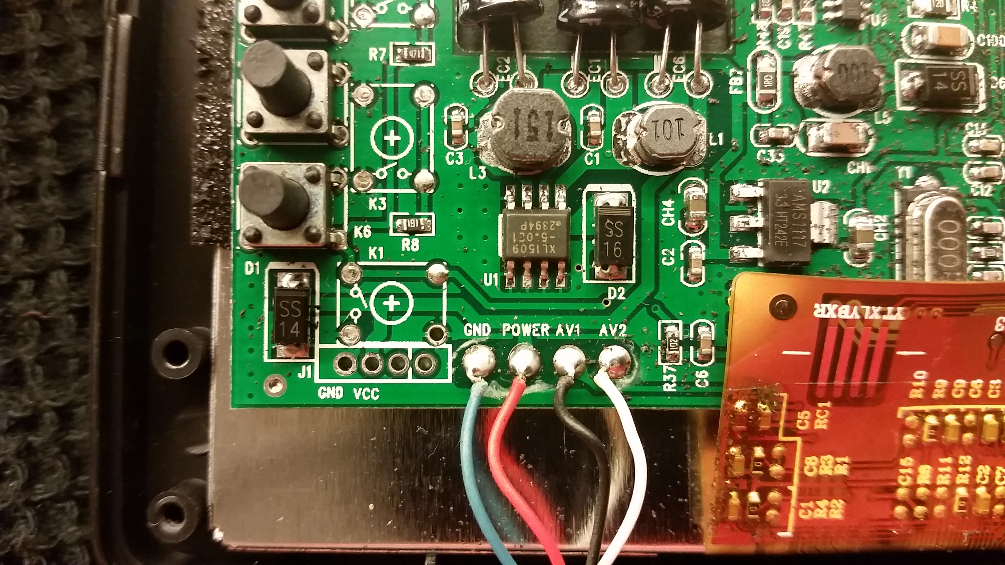

The back is unscrewed.
The wire I moved through the A-pillar on the driver's side and connected it to ground and the reversing light.

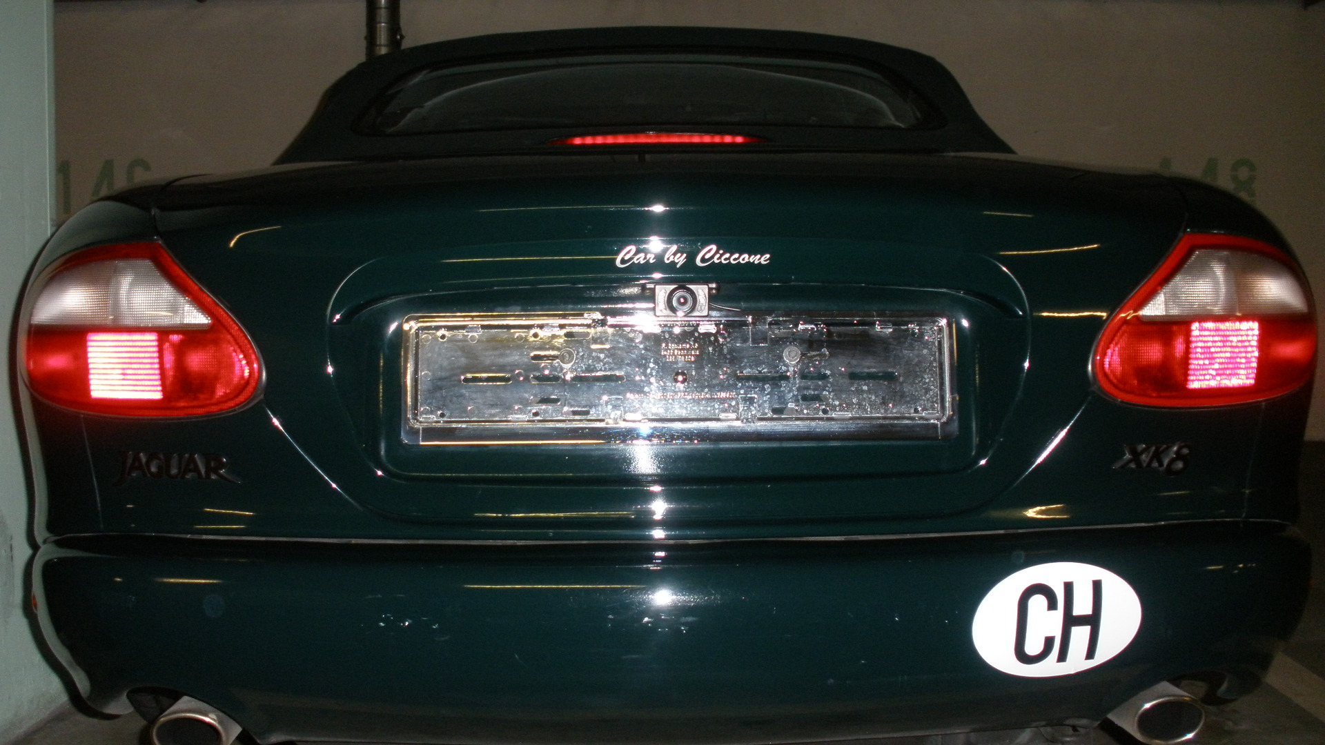

The reversing camera I Installed above the license plate.
It was not easy, but I am very happy with the result.
