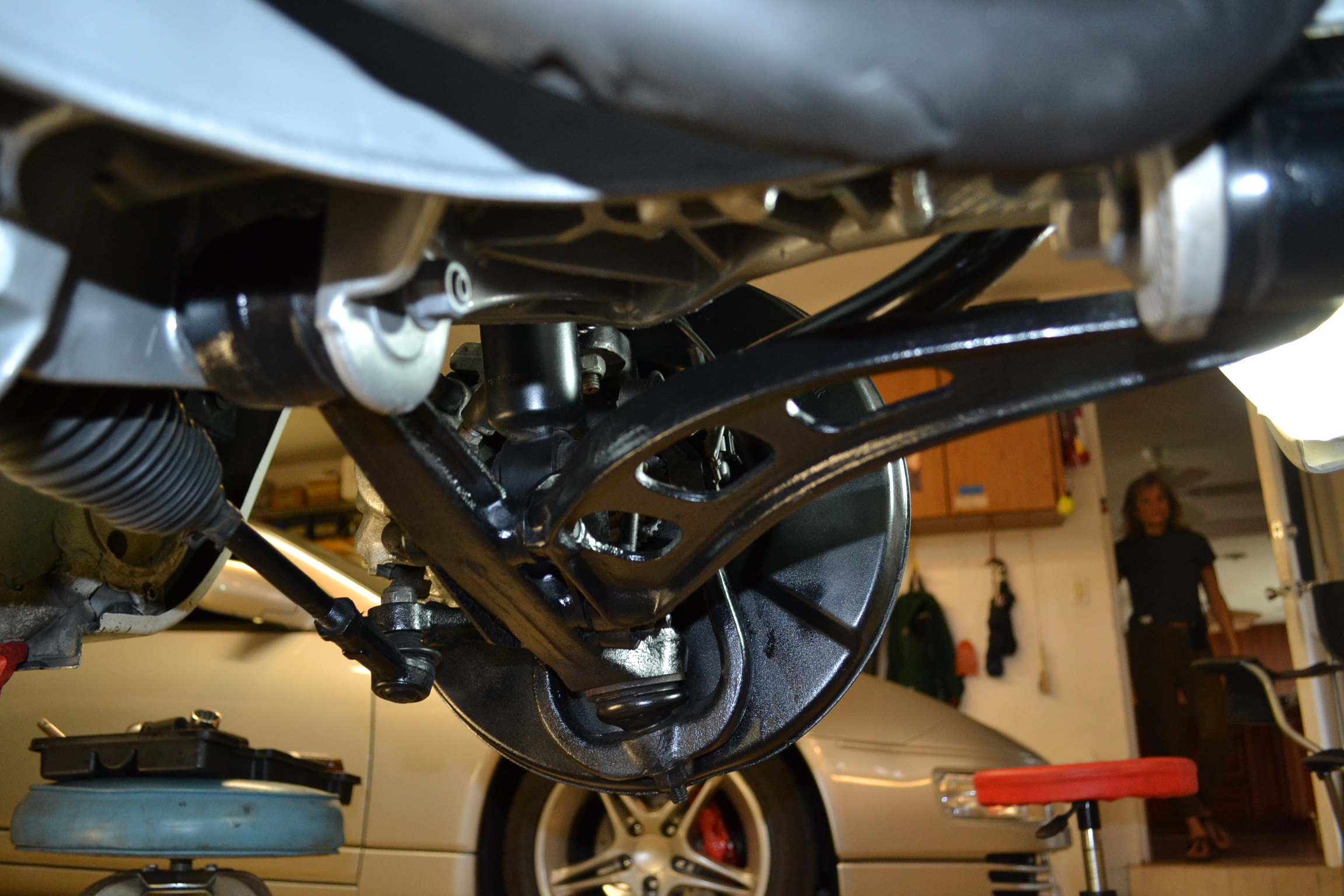

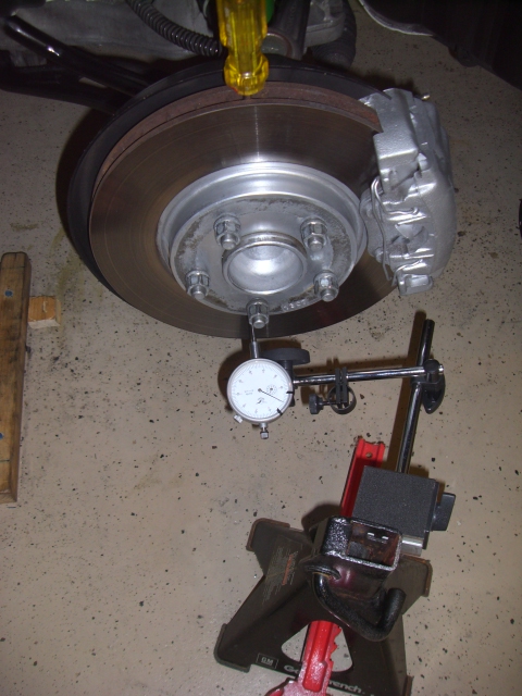

The first thing that came to mind was the dust sheid, which is easily deformed, became bent and is rubbing agains the rotor. But, you said you checked for the rotor for scraping against the dust shield backing plate as in the pic below, correct? I assume when you did that and check again, you had the rotor bolted tight against the hub assy? Better even if you remounted the wheel, maybe?
Possible that the rotor is out of plane and scraping something on the caliper? I've checked for runout when nothing else seems to be logically causing something like what you describe.

Totally different subject, what paint did you use under there? Love the finish.
Old Jun 23, 2017 | 06:59 PM
GordoCatCar's Avatar
Joined: Dec 2007
Posts: 1,408
Likes: 494
From: Ormond Beach FL
The black is standard off the shelf black enamel. Probably from Home Depot or Ace Hardware.
The silver is G2 caliper epoxy / paint.
