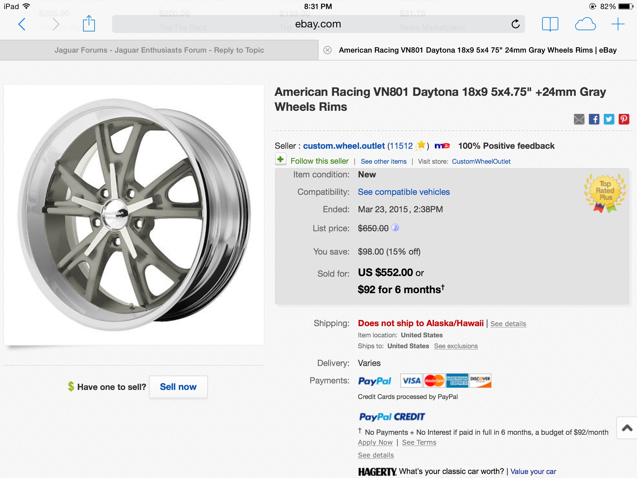

I got the American Racing VN801 Daytonas. Have not put them on the car yet as I just got back from a three week vacation. Having tires mounted tomorrow.

Id love to see those on the car. Kind of like the look
