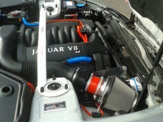

all the work I have done on the front of mine I still do not like the feedback through the steering wheel at times. I wonder what a strut brace would do for it.

All I can say is I had 20inch wheels without strut brace a few years back now back on 18s with strut brace and I find the car to have a much smoother ride
