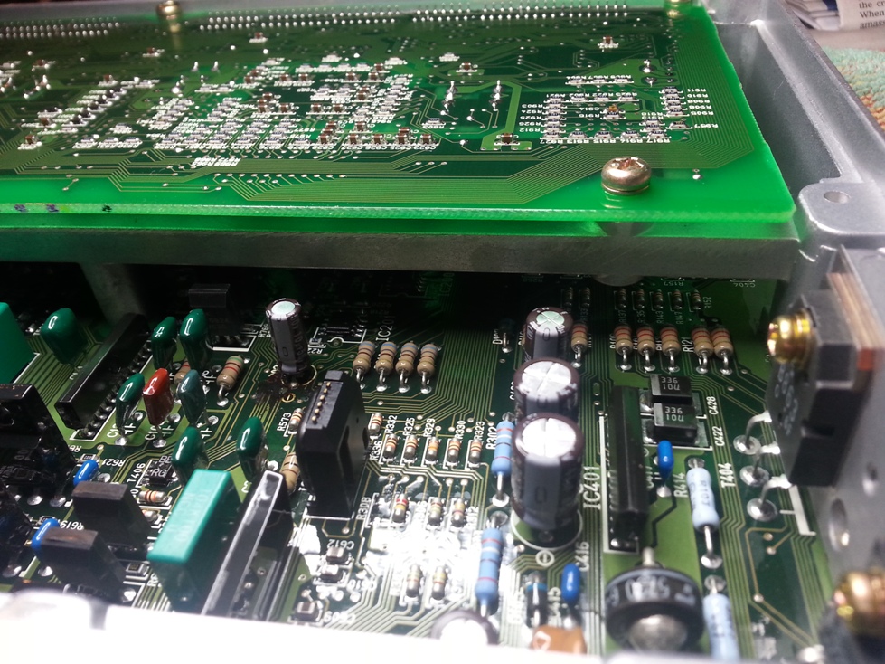

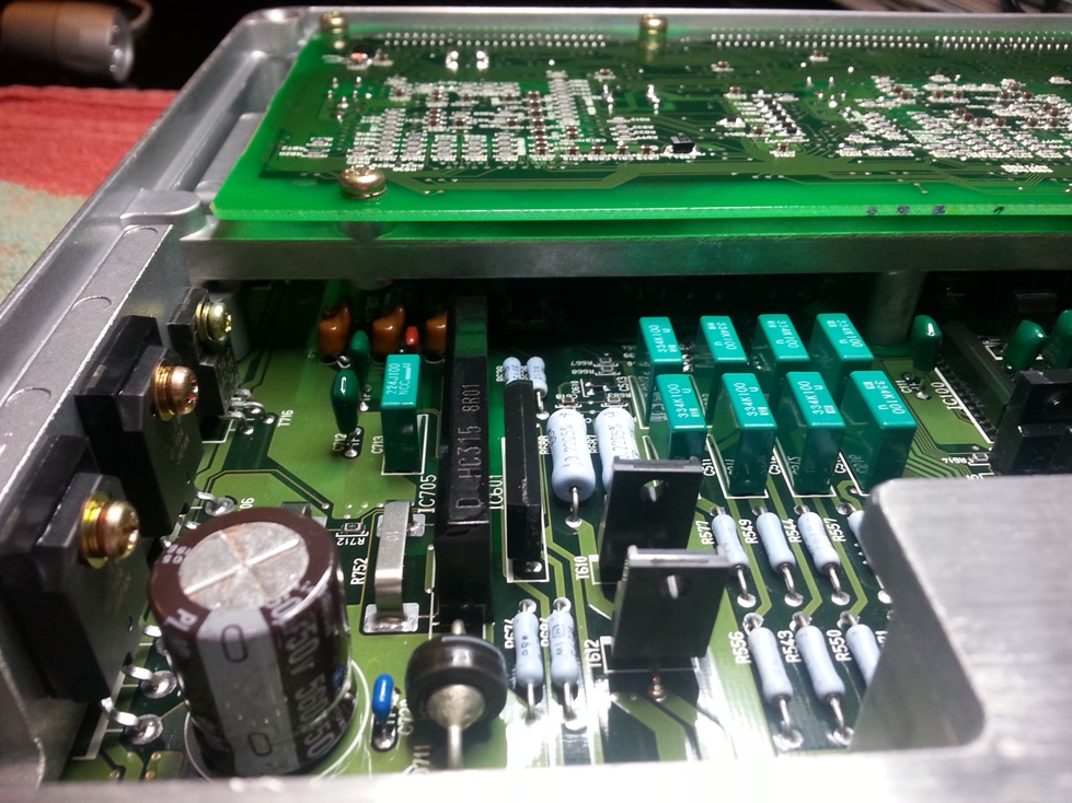

From: South Carolina
OK Steve-
I've got the ECM out. I could only access the circuit boards from the side shown below...I've got a problem screw on the other side of the case.
Everything that I can see is bright, clean and shiny. No burn marks, leaks, etc...at least not to my untrained eye. I can't see everything from this view...I'm hesitant to remove the screws holding the second, face down circuit board...but I'll attempt it if you ask me to!
But what I can see looks good, as you'll see below.
BTW, this is not the car's original ECM. Manufacture date is June 1996, car was sold in October 1996, and this ECM is dated November 1996.

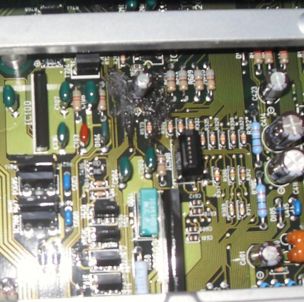

Holy ECU Batman...I think I see a smoking gun!
Attached Thumbnails RPMs drop at stoplights...sometimes stalls...doesn't happen when in neutral.-coupes-ecm.jpg
Old Sep 16, 2013 | 08:00 PM
Posts: 25,873
Likes: 4,710
yep - steve take a look at his second pic - you get a better view of that area

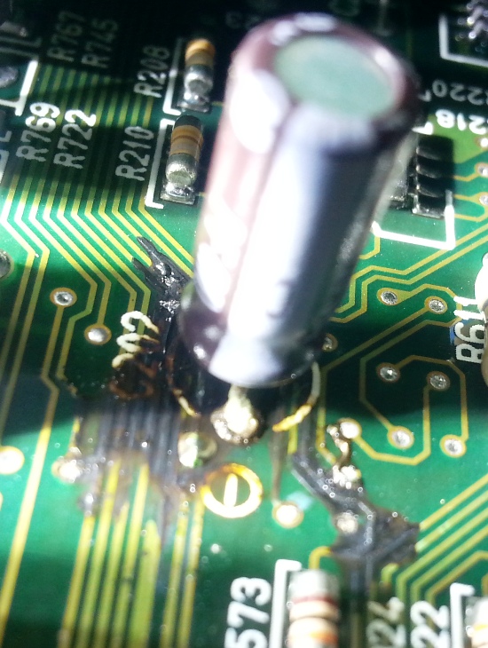

The Coupe's Avatar
Joined: Aug 2011
Posts: 1,294
Likes: 372
How the @#$%^& could I have missed that?!
No way to tell what problems this is or isn't causing, but clearly something that needs to be addressed. What's my best option here, Steve?
Attached Thumbnails RPMs drop at stoplights...sometimes stalls...doesn't happen when in neutral.-ecmleakingcapacitorsep162013_zps02c230bb.jpg
Old Sep 16, 2013 | 08:25 PM
WhiteXKR's Avatar
Joined: Apr 2010
Posts: 7,657
Likes: 3,021
From: Arlington VA USA
It is hard to tell positively from the picture, but I think you have some moderately severe PCB track corrosion damage. Though it is possible, that is difficult to repair well for something as critical as an ECU. In addition all the electrolytic caps should be replaced. Then there could additional be non-visible damage from short circuits.
Given all of that, I say a rebuilt replacement ECU is your best bet. If you get a used one, you run the risk of going through this same scenario before long.
