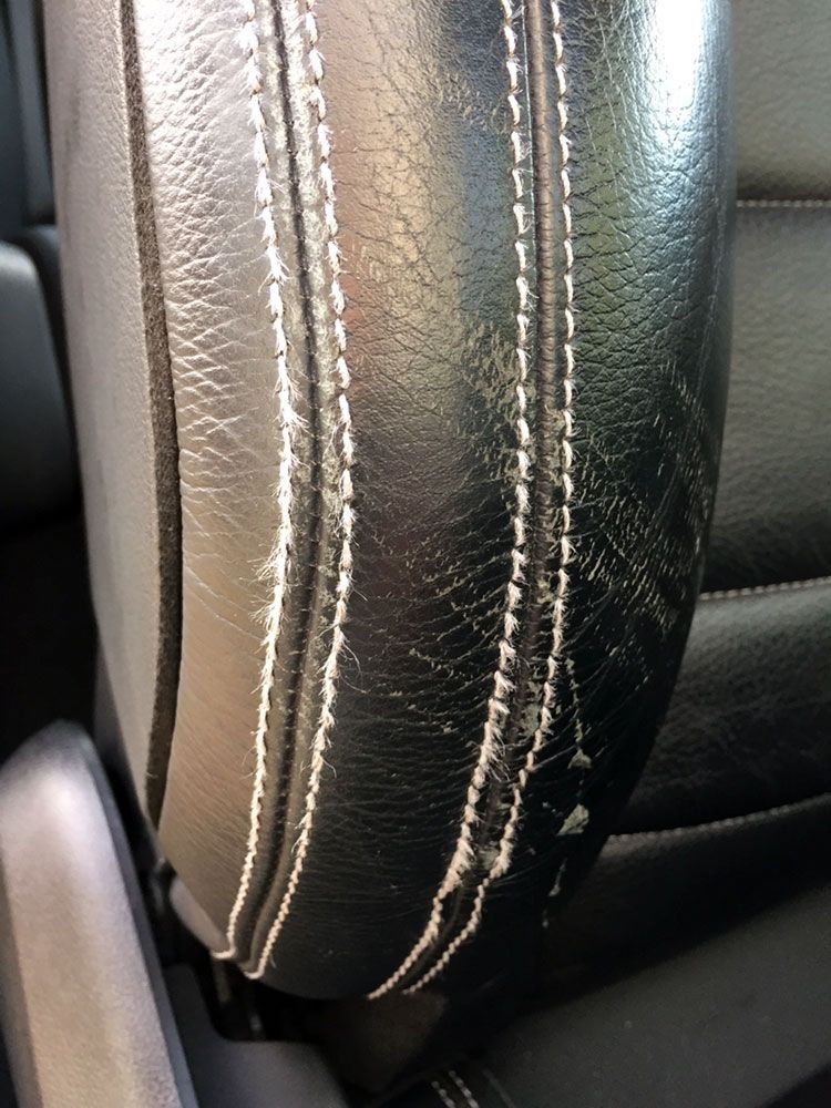

On nice cars like Jags I certainly wouldn't use a leather repair DIY kit, the problem is the 'pigments' in these kits are not really pigment but a leather dye containing a self-finishing compound. These will not repair any damage, simply colour it and fill it in slightly. A true restoration would be to apply new leather pigment after fully cleaning and preparing the seat, this then needs to have pure surface finish applied to ensure the leather will wear like new.
The DIY kits will wear back to the same state quickly and will suffer from dye transfer.
Here is a real restoration of mine!!...
before restoration
after restoration

Pheonix, that's a nice job. Can you say a little more about what you used to get this job done? I'd like to fix my oatmeal driver's seat's scuffs.

This is a professional job and the materials aren't available to purchase. I could send you some decent recolour product if you post some images I can colour match it for you and send it on but won't be as good as a pro job. Where abouts are you?
